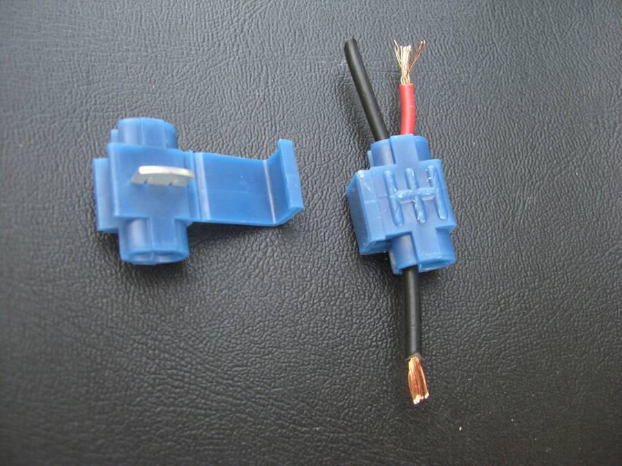

Easiest method is probably crimp connectors.
You don't need to cut any wires, simply fit the crimp over the wire you are tapping into, and insert your other wire into the other side, then squeeze with a decent pair of pliers. Give it a tug test to make sure its sound and you are good to go.
Buy a few crimps and practice on some spare wires first if you need to.

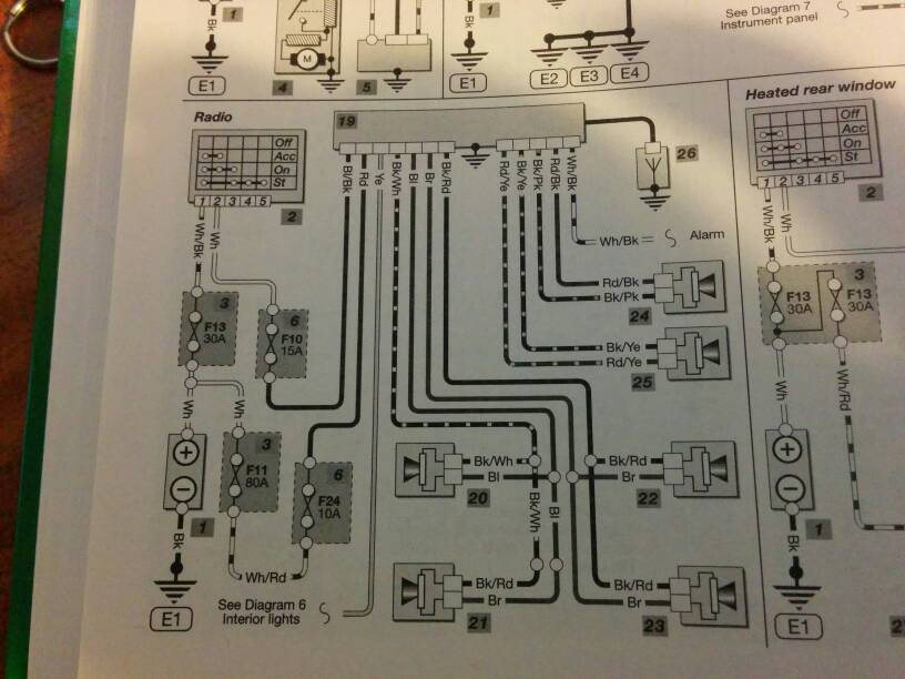

Good pics, but i cant reconcile what that last plug in the last pic is for, so lets ignore that.
Firstly you need one of these. I's a test bulb, you clip it onto a good earth, then use the pointy end to test if something is 12v. Even better would be a multimeter but we may be getting carried away a bit there.
I have checked the K11 wiring diagrams (if you don't own a Haynes manual, add that to your list too) and it looks like the solid RED is +12v constant (keep alive for the radio memory), and BLUE/BLACK is IGN +12v (so when you turn the key to ACC).
BUT YOU NEED TO TEST THESE FOR YOURSELF TO CONFIRM, hence the test bulb. If you wire things up wrong, you can short things out, start fires etc. Not good. So check everything in case I'm wrong!
Once confirmed, Tap the RED wire on your new socket (keeping the fuse) into the BLUE/BLACK wire.
The other wire on your socket needs to be earthed, so stick a ring connector on the end and secure it to something that goes to ground.
Once wired up, you can test the socket with the push lighter or just shove a charger plug in there.
Below is a pic of the relevant wiring from the Haynes manual.
Hope this helps, but PM me if you need to.
Regards,
Chris.
