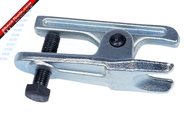

undo the nut holding the balljoint to the front hub (wirebrush n oil the exposed rusted threads first),
loosen the locknut thats locking the tie rod end to the steering arm,
seperate the balljoint from the hub using this (not the wedge style tool cos they wreck the balljoint rubber covers)
note how many turns it takes to unscrew the tie rod from the rack,
install the new rod end with the same number of turns as the old one,
tighten the tie rod locknut and the nut holding it to the hub
