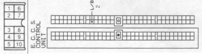

i have just e-mailed you a colour diagram of what titch is talking bout...
wiring to the ecu is more neater (i was just lazy)...
what titch means is:
disregard the dizzy(repair any splices)
now wire into the black block(blue/black wire)
there are 10wires here 6 at top 4 at bottom of block
of the four you want the top right one(labbled two on the diagram i sent you yesterday)
then run it to the ecu (look for same colour wire, also lablled 2 on the diagram i sent you)
test it now with all plugs in the back, ign on....
