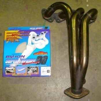

I am pretty sure that there is aircon stuff in the cabin - there are manifolds in Japan thst are bent to allow the exhaust from cylinder 1, but probably easier (and cheaper) to move the alternator down.
All you need to remove to fit the janspeed is the aircon pump as it sits in the place normally used for the alternator, the rest of the aircon kit can stay in situ if you wanted, but it would be dead weight, the alternator can then be moved to its regular spot with the right brackets.

See how it is made to clear the aircon?

You'd really need to speak to someoe who imports a lot more than me - I can get stuff off Yahoo Japan, but there are no K11 manifolds on there at the minute - you could try giving perfectrun.com.au a mail as they were very good when I brought the Tomei's over.
I can keep a look out for you if you want, but be aware that shipping costs will make up the bulk of the price.

i was aware of these manifolds but didn't take note of any of the companyies name. which is more anyonne now as i know some that might be able to get bits for me from japan. all i need to know is names of the aircon exhaust manifolds.
yes i bet its 50 to 100 quid shipping (maybe 1/2 that if was group buy)
but its an option if you,ve got aircon tho eh
