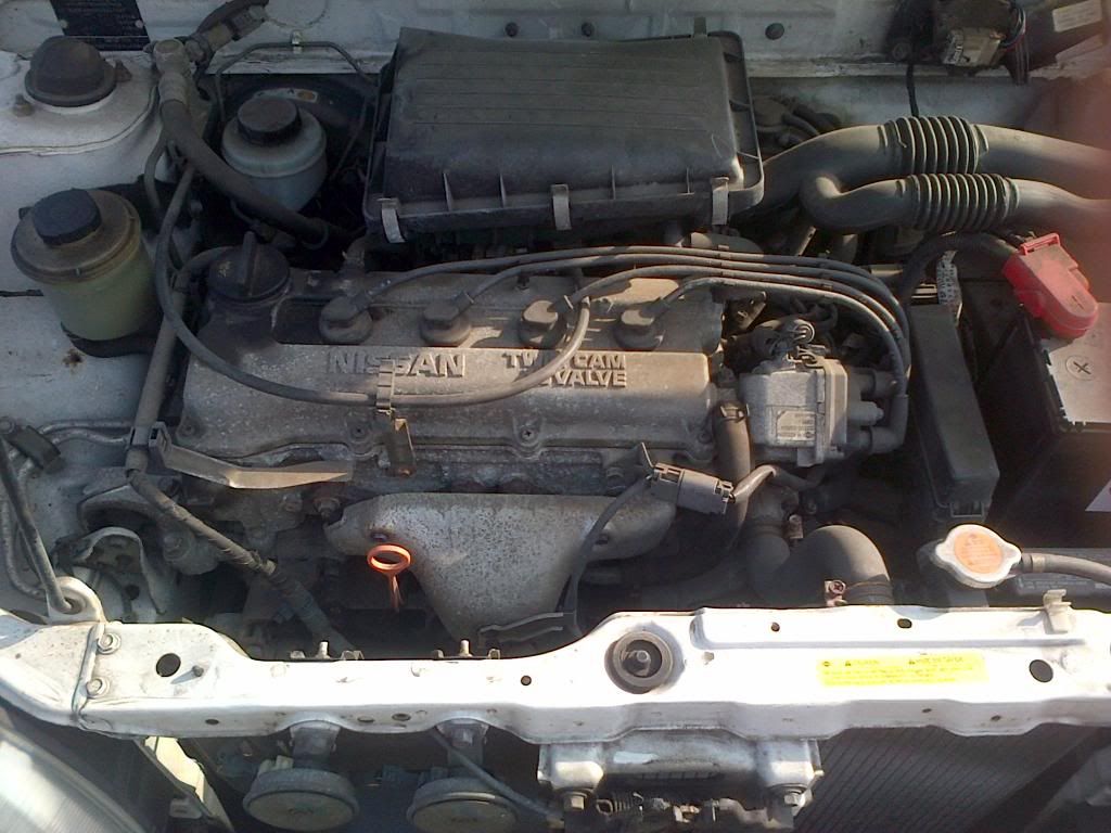

Easy to fit the Air Box/Snorkel?
Almera/100nx boxes require you to remove or modified the positioning of the carbon canister, as its bigger and the canister sits in the way of it going on properly.
I got a smaller canister of a preface lift micra that had, had the mount already trimmed
