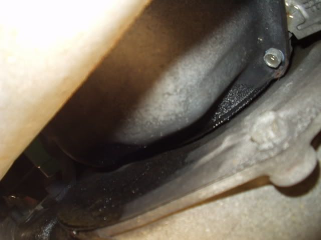

....and i've just found an Oil leak..:( it looks like the Crankshaft rear oil seal has gone....shall i start another thread? :laugh:
If its the rear crank seal, your clutch could start slipping when the fly starts flicking it around the gearbox bellhousing. if it does start slipping then you know its the rear seal o_O

It's not that bad as it's not dripping on the floor......yet.. :(
Clutch is up for renewal, so i'll get the Seal changed as a matter of course... :)
