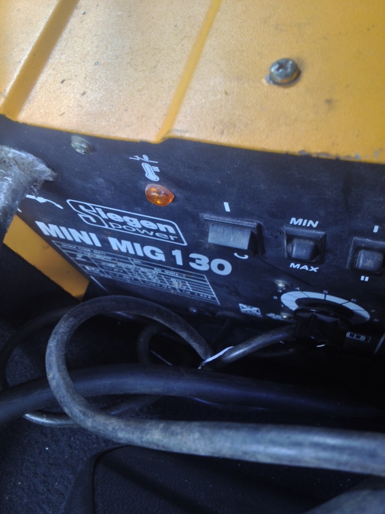

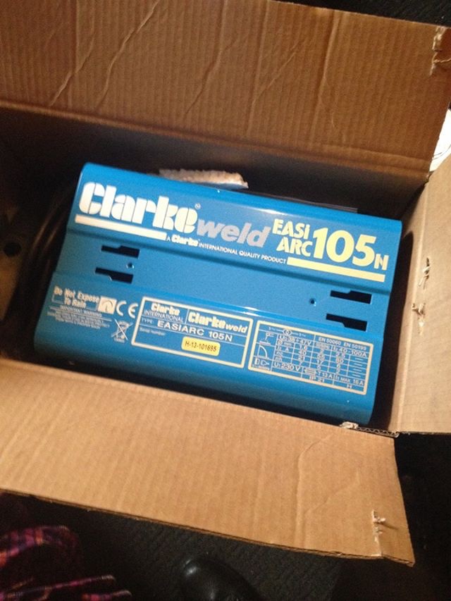

right this is my arc Clarke 105 amps vs my mig welder 130amp gas or gasless just bought, after seeing @Tom west get both his mig and arc I seen both welders do Diffrent jobs but in Diffrent specs
First I was suprised how good his mig was and how clean it was without burning anything and the welds was very stong and easy to use. The arc welder was next to him so he tryed that on and that came out clean and strong using 2mm rods, both welders are very good so I bought a arc and now got a mig after watching both do Diffrent things, mig is all rounder defo for me, arc is good for all type of weathers, but can stick at times, and can't do very thin metal like 1mm. The mig does well on thing and think, and decent looking welds, I learnt so much from Tom and explained and showed me how and what, thanks mate
