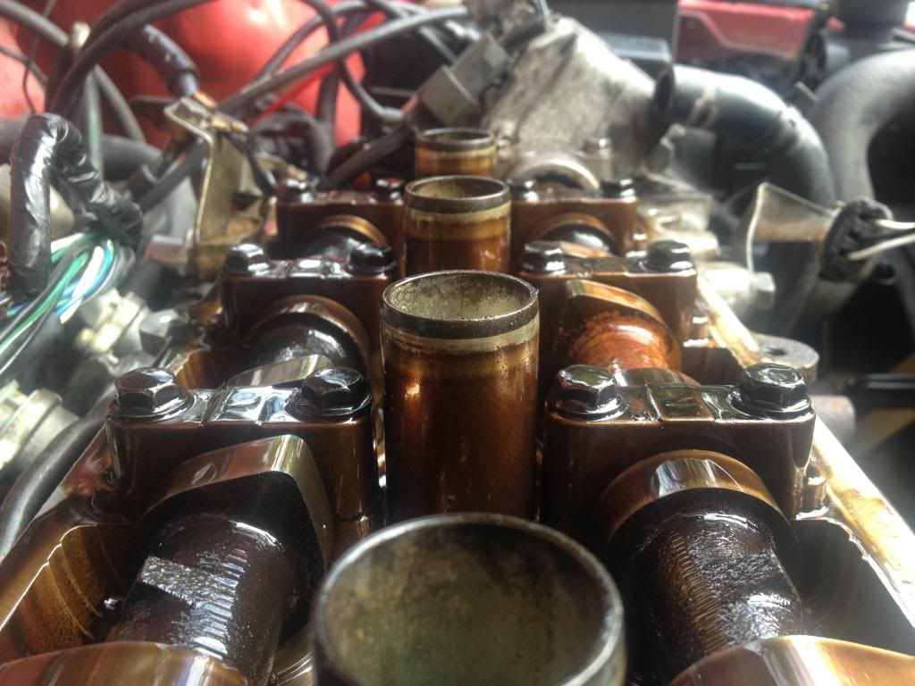

yes "lobes" username "frank" should bring some pic,s up :) and on cisco,s too, i always line the lobes up with the side of the bolts as in the pic,s (@ tdc)
Ok so I can get it to start but it runs majorly lumpy. I'm wondering did i distort the head and need it skimmed or is it still out on timing. Compression test won't exactly show me I doubt?
I set it so that no. 2 and 3 were pointing as you've shown frank (inwards with lobes lying alonh the upper guides. Ill get a pic later incase it's not.

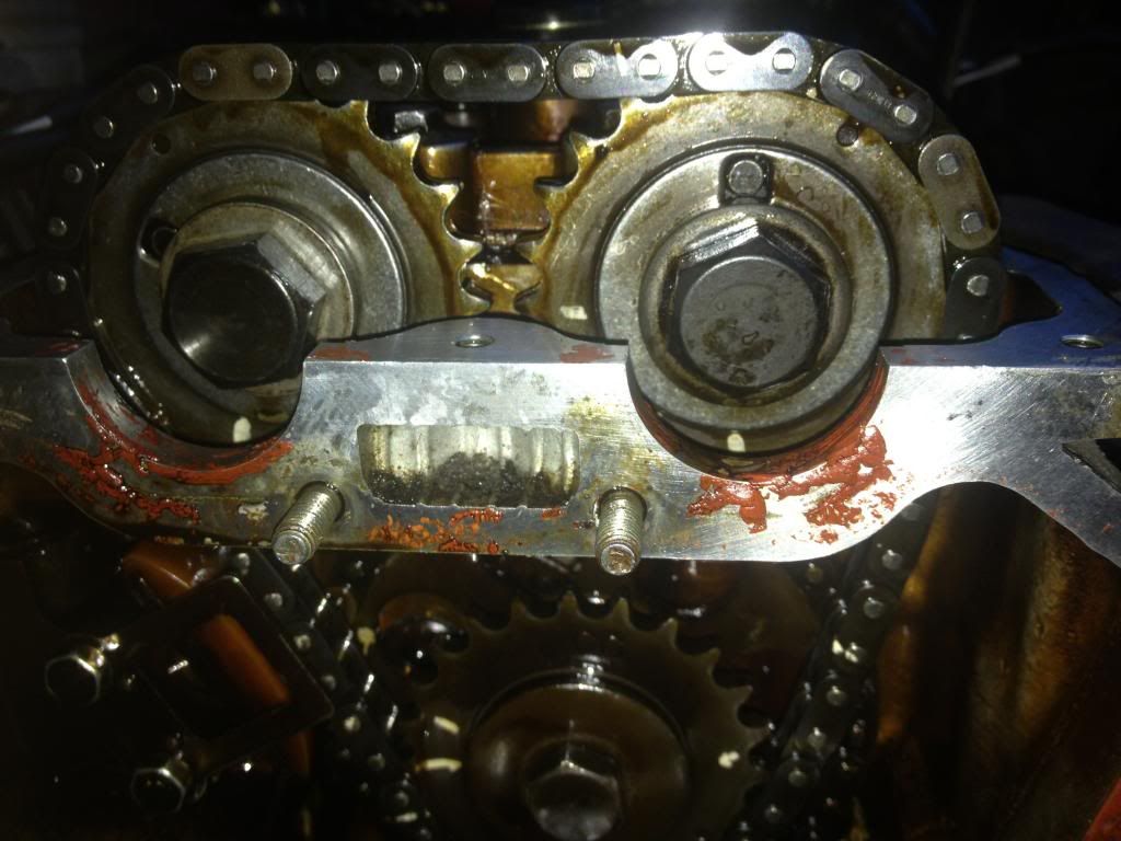

I was thinking it was the timing still, but that looks right to me?

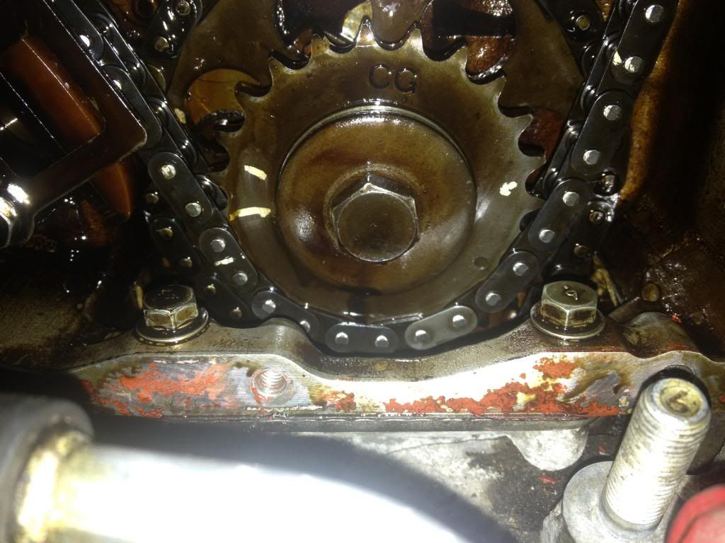

OK - so i look to be an entire link out? Would i need to take that idler bolt out to rotate it around? Looks to be a little casting piece directly below in the way if i was.
That said, maybe they would line up if i turn it another million times? I got bored though, but maybe that's what's ####ing the whole thing up!!
