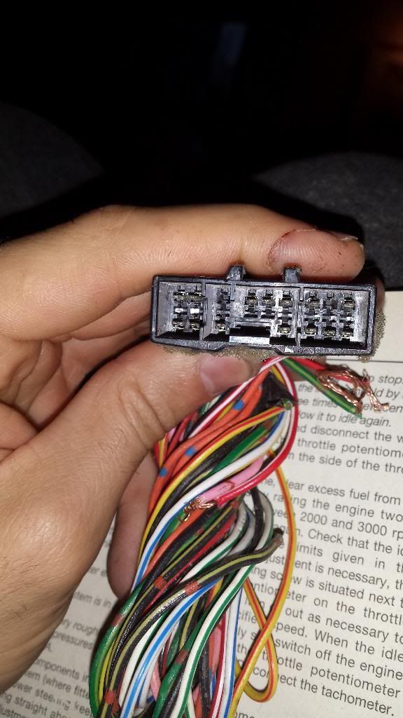

It's a 1993 cg13 loom in the mini but I'd left off the diagnostic plug (kept it in the garage incase I needed it)
I have looked at this plug after wanting to buy a diagnostic cable....but I can't find anything like it? It's not nissan consult or obd1 :so
I remember when wiring everything in the mini I wired a momentary toggle switch into the loom to bridge the two terminals that do the self diagnostics with a flashing led on my dash...The wires I had to bridge were in a different place to where the Haynes told me they were and the connector I have looks different.....
This was the only free connector on the loom :(
Must be diagnostics though because I have the same wire colours the Haynes gives at the plug! Just a totally different connector :s
Does anyone have a few photos of their diagnostics connector showing the pins and wires so I can work out which pins to connect wires to on the consult cable :)
Yep I've got all those wires and now I know where to put them in my consult plug. Cheers frank your a star :D really appreciate all the help u give :)
I'm just going to solder the consult straight to the wires, then when I want to access it just plug my serial to usb into the consult thing should work right? :p

have you got the ecu pinout diag ?
Ah okay it's just earthed normally yeah?
Yep gothe the Haynes. I reckon this diagram is looking into the front of the grey connector after having a look at your picture
yeh, the black is earth eh tom, pink to the fusebox red/white to pin #14 yel/red to pin #23 red/black #15 white/blue #7
i can email the diag if you want
It's okay frank, I think I left the wires attached to the ecu plug so should be able to find them easily with my awesomely tidy wiring hahaha

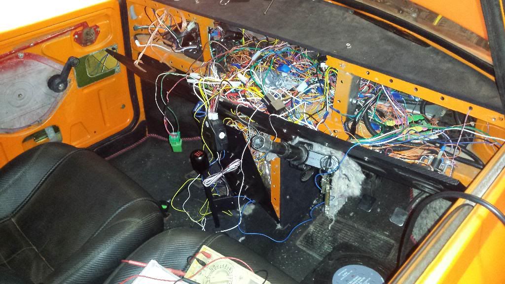

Errrm well ALL the wiring in my mini was made by me (except the micra engine loom) so I didn't have any mini loom at all.
Why don't you leave the mini loom in place for all the lights & things and just use the micra engine loom?
