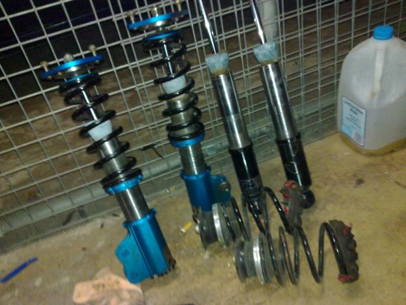

Stripped car... Pulled these out.
Cleaned them up, As from my previous experience dirty coil overs are so very painful to adjust! Always clean a thread with soap then adjust. Tape them up with electrical tape.

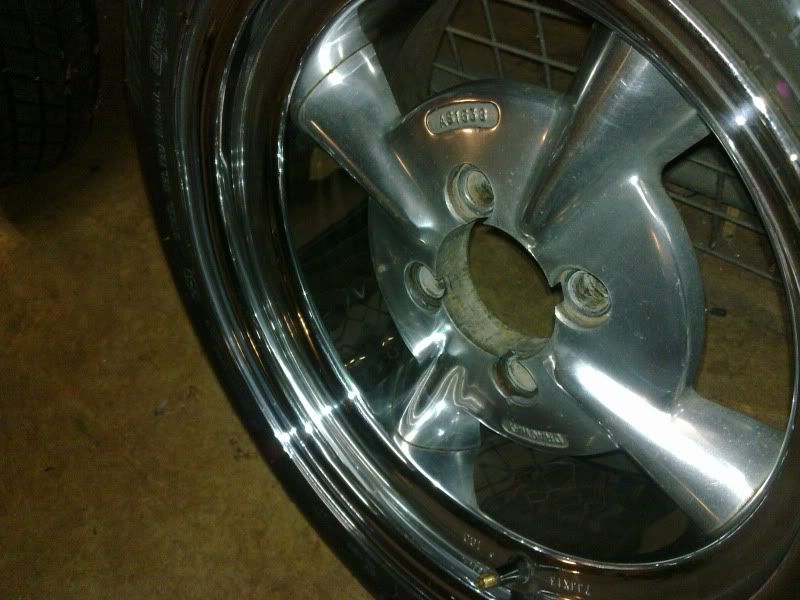

Also decided to restore the tired looking Dragway rims with tough offset but will most likely run spacers. Going to get a metal polishing kit for the centres tomorrow. Looks like the barrels have been polished before.

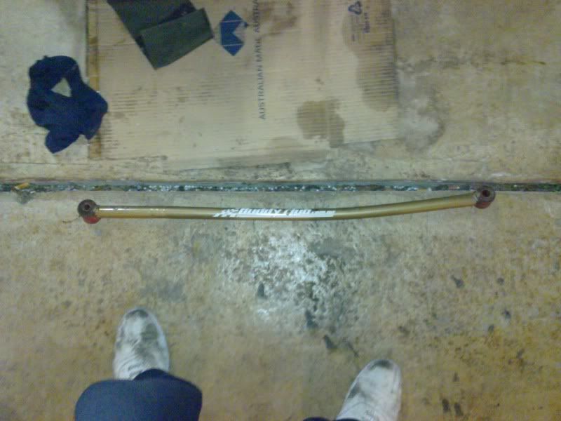

Then I stumbled on this.. Is this bent or is it designed this way? I does have some knocks in the metal but the curve is fairly direct can anyone suggest if its ok to use?

I've got a feeling it may have been done to pass the exhaust, just sprung to mind. Seems its not a big issue and quite common to do? Does this not cause an alignment issue?
That's the way it was designed, don't straighten it :)

Tried to fit the rear coilovers to my car today, I can safely say what a pain in the ass! Im fairly sure I've stripped one bolt already as they are on so tight/so dirty. I also broke my wobble head on the ratchet. Can anyone suggest if I can use an electric drill as an impact gun for the bolts?
Have not had a problem on anything else, just on the suspension I even removed the brakes lol.

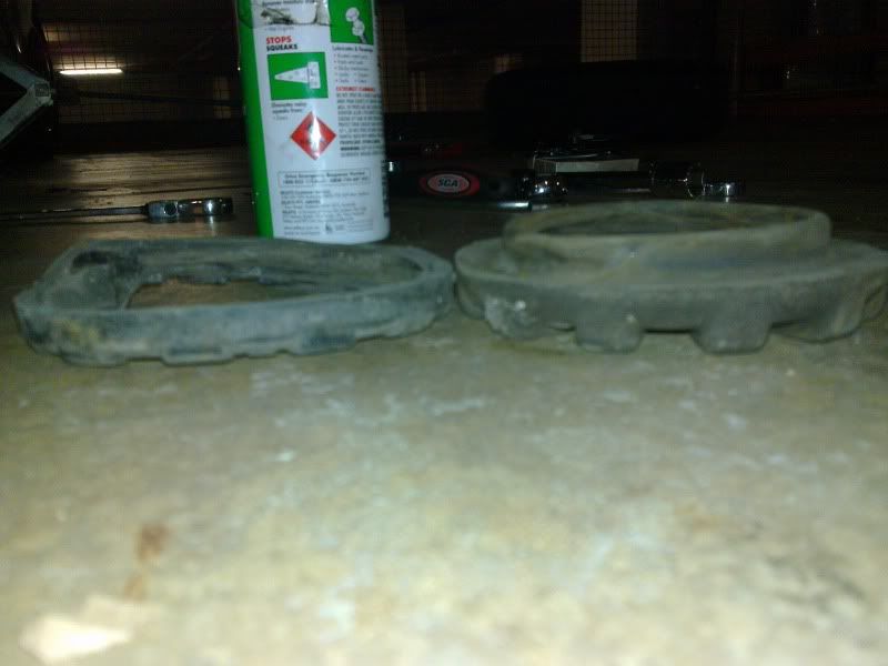

This is the result of cut springs over the years..
OLD >>>>>>>>>>>>>>>>>>>>>>>>>>>>>> NEW

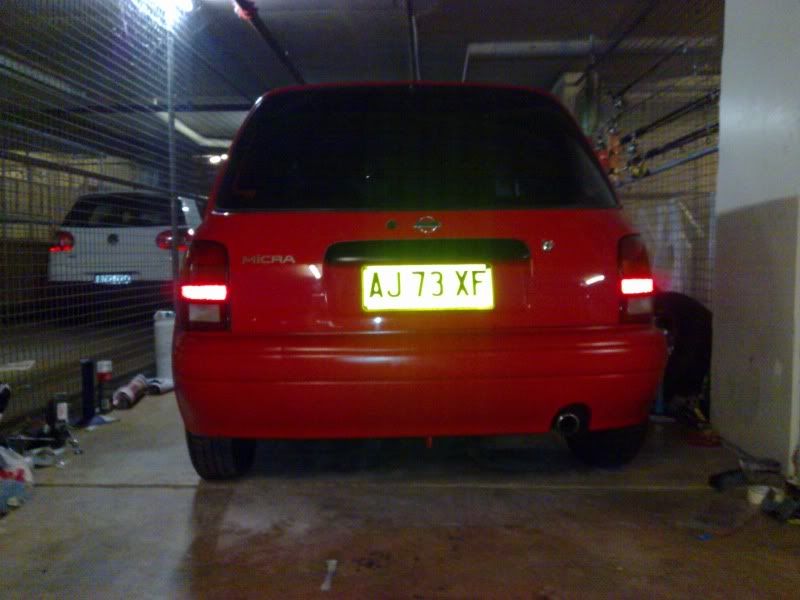

I installed the exhaust today, what a pain in the ass. The headers required removal of the aircon fan, alternator, compressor, plate which holds up the alt and compressor and basically the whole engine lol.
I've managed to mount it up however the rear has been bent in the accident so zip ties are holding it up atm lol. Tomorrow i will be taking it over to Midas (down the street thankfully) to get them to press bend and weld a new pipe onto the muffler. lets hope that it is fairly cheap I cant see it being expensive but you never know. It only bent about 4cm but the difference it made down the end was amazing.
I have to say, If you have never removed your exhaust and started the car with the manifold only it is the most fantastic sound. Just imagine a quiet V8, lumpy idle with a rally engine sound. Music to my ears!

turns out its 150 to unbend it. I told them to piss off. Zip ties for the win: cant get much more back yard than zip ties

$150 to straighten the panhard rod?!?!?
if the shop has the right tools it'll take less than 5 mins.
i'd use a couple of lumps of wood, a doorway and a bottle jack to press it straight.

No $150 to straighten a bent exhaust. After I told him it was a joke he told me It has several bends. I said yeah its an exhaust it goes from one end to the other. The only bend im worried about is the one on the end. I then left in a fury of rage and im pretty sure my hair turned blonde and I became a super sayan. Ha!

No they said "Its a few bends sir"
I rang another place today, "oh mate sounds fairly simple. About $40-50 dollars" .. Oh righto I said, Ill bring it around soon.

Turns out it was fairly easy fix. Oxy torch and metal bar and it is nice and curved correctly. Cost $50 bargin!
Unfortunately it resulted in the exhaust being quite low and it sits quite abit lower than where it originally was but I may drill a hole somewhere and add another hanger. Just to avoid it hitting too much it just taps big speed humps now so not too worried.

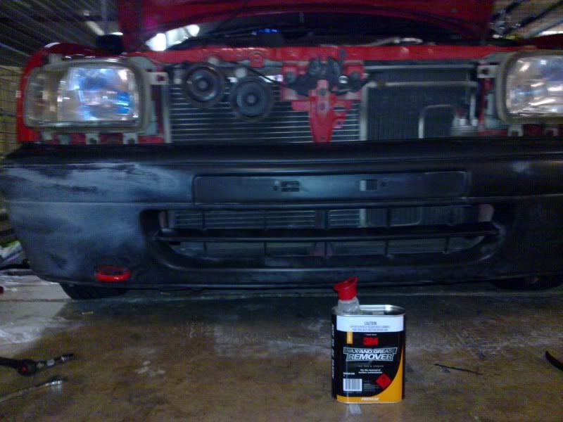

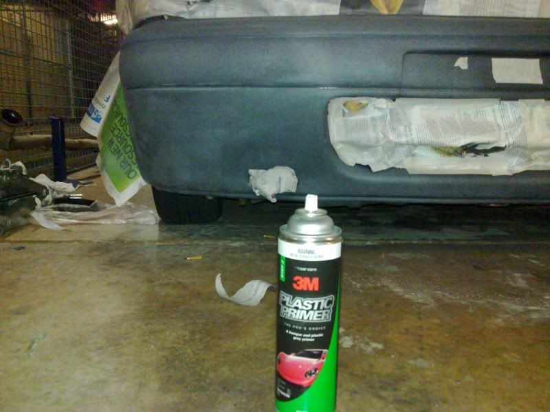

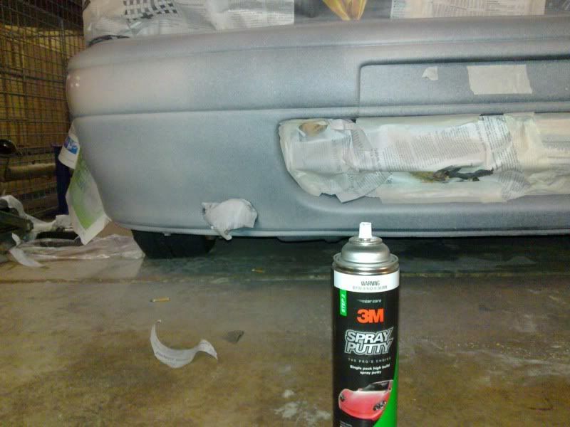

So thought I'd throw a DIY in this for painting the bumpers..
You will need:
Sand Paper - 250, 400, 800 & 2000 (I used more but thats what you'll need)
Wax and Grease remover (Im pretty sure acetone will work too, dont use kero, metho etc anything oil based)
Plastic Primer - 1 Large Can
Spray Putty - 1 large can (use sparingly)
Paint colour of your choice.
Newspaper
Masking tape
About 2-5 hours of time.
So.. We begin.
Im lazy, So I did most of the prep on the car. I highly recommend removing the bars to paint or prep but I have to use it daily so its pointless as the bar is a PIA to remove.
Rub down that bumper, dont think its a one application affair, Several applications of Wax and Grease remover is required. Most of you including me have most likely spent ages coating the bar in silicone to make it look pretty. You now spend a good hour to remove it from the bar. I did about 10-12 applications and removals of each bar. You apply on clean rag and wipe it off while wet.
Let it dry for 2 minutes.
Sand down bar with 250-400 grade sandpaper. Spend ages on this, its important.
Mask up if you want to leave it on the car. Spend awhile on masking!! Then apply a plastic primer. This is quite thick so quick even thin coats is always best. Apply until most of the bar to covered. I use the grey spray as I can see where its going. It comes in clear also. It also makes a good undercoat & sealer. 1 - 3 coats
1500-2000 grade sand back. Very light just to keep it smooth.
Spray putty. Apply this lightly and work up. We will be sanding this back from 400-2000 so I would apply a minimum of 3 coats.
Before Ive sanded it back, I will hit it with a quick 400 and then jump to a 850 and then 1500 and 2000. I wouldnt spend to much time on each as the putty is very soft. 2000 would be a nice good rub down. I wouldnt go to wet paper as the paint will stick better with the dry sand.
You then reapply the plastic primer for the two reasons, better adhesion to paint and also its sealing properties.
Paint to come, Ive yet to get some packed. Will hit up auto one soon.
I also want to work out If I should remove the front grill. Its a little bit of effort but it may look better.

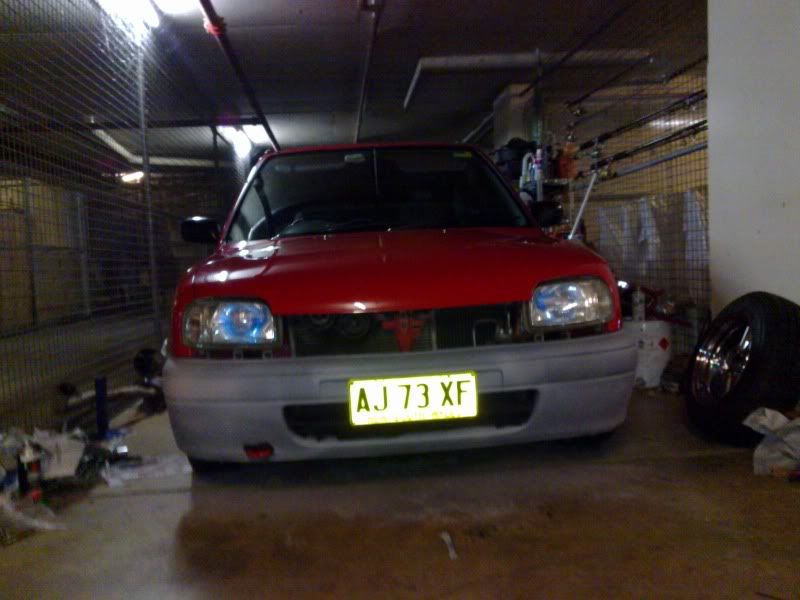

Sprayed the bumper today, turns out that Red I needed is not the same as what was in the can lol. Red is very hard to match and I knew this but tried anyway. Ill post up photos later and you guys can decide if I should keep it red or spray it black.
Im slightly angry, Im hoping a highfill gloss will help melt the colours together.

off the shelf can. Im pretty picky when it comes to paint and in daylight i cant pick it just in dark light. Ive got a photo its got no clear just yet so please forgive me for that.

You cant see much difference in the photo, apart from the matt finish. Its pretty clear even though the car HAS been resprayed in AJ4 it has faded. In saying this .. I saved $150ish dollars. Being a budget build thats pretty good.
