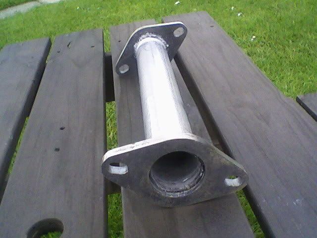

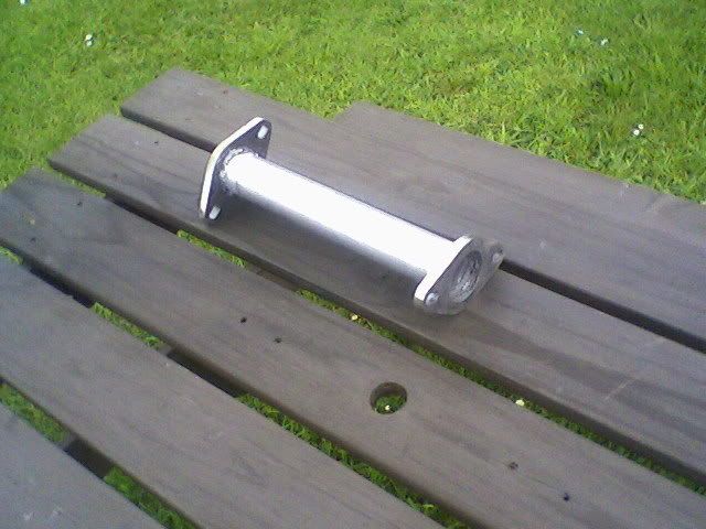

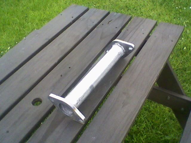

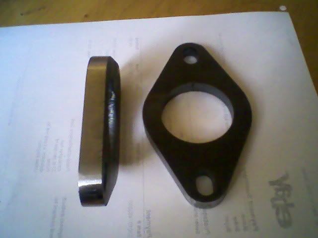

I have been looking for a decat pipe for the 1.0L and have found varied prices some expensive some are not. anyway i have made some flanges the same size as metal gasket but 1cm thick you can buy a mild steel pipe from auto discount shop for about 10 quid per 2 meter. so if you remove cat and make a jig so that the flanges bolt to jig then weld in pipe bobs your uncle fanny,s your aunt cheap decat pipes.
