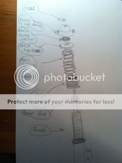

Did you use the set-up 'Spring>corsa top mount>micra thrustwasher>micra top mount'? If so where did the spacer go in the arrangement?
Edit: This is the set up i used (pardon my quick sketch!) is this the same as yours but without the spacer? I need to add the spacer as theyre much too low for the tyres ive got currently
Good drawing..! yes thats how i did it, the spacer i was reffering to was used between the top securing nut and the micra top mount not to gain height but to reduce the length of the threads poking out the top of the shock, if that makes sense..?!
the other way it could be spaced is, threaded part at the top of the shock is about 30mm then it is blank for 30mm, you could put a 30mm spacer over the blank area thus lifting the height by 30mm.

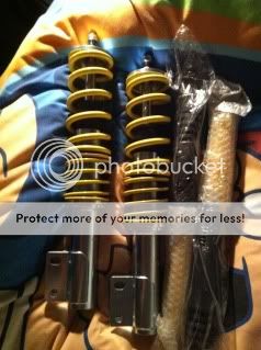

Just thought i'd share an update with the people interested in fitting corsa coilovers. My front coilovers are now done, complete with 15mm spacer under the top mounts. Had a bit of a problem with them yesterday night however as my offside coilover worked itself loose, and was knocking quite badly. I thought this was due to a partially destroyed micra thrust washer (the plastic thing under the micra top mounts) which i foolishly thought would be alright. What i think was happening is that it was causing too much friction and allowing the nut to stay still whilst the shockrod itself rotated, therefore undoing the top nut (i took a video at the time becuase its so much easier to explain). I thought the other side would be alright as i knew the thrustwasher was still intact but after testing it with the front jacked up, it was doing the same (this is the side shown in the video). So at half 11 last night both my front coilovers came off, got dismantled and both thrustwashers got removed so i had the setup of shock>spacer>corsa top mount> micra top mount>top nut. The corsa topmount has a bearing race in it so it allows the coilover to rotate and after re-fitting on the car and testing again, the wheels turned without the thread or nut moving so im hoping this has solved the problem.

Hope this helps :)
Was a hell of a lot easier than trying to explain it well lol. Thats what i was like before, no movement now though so hopefully its cured :)

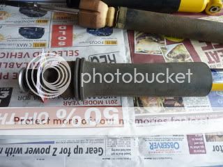

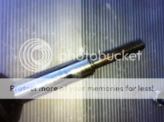

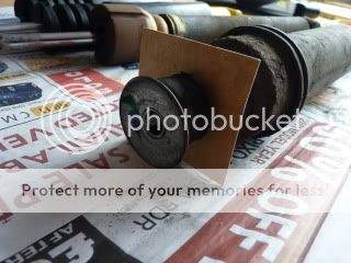

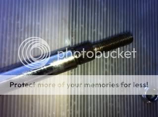

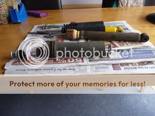

Have started on the backs today, but like the fronts, im a bit confused as to which micra/corsa combination is best (help?!). Also, the bush sides need to be ground down so it fits (which has been mentioned already) but what's also needed is a smaller diameter nut and bolt, as the hole in the bush on the corsa shocks is smaller than the one on the micra units.
Just took some pics of the problem. The first pic is the individual parts i thought would be the best set up and goes: shock>washer that came with corsa suspension that sits on the lip on shaft>micra sleeve/topmount>micra lower bush>car>micra top bush>micra top washer. Other pics show lack of thread.
I'm stumped.
