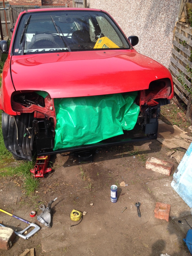

made mines by self for only 10 pounds box section, take spot welds out and design one, simple and stronger and doesn't rot easy, mines removable, got a full build pictures too
