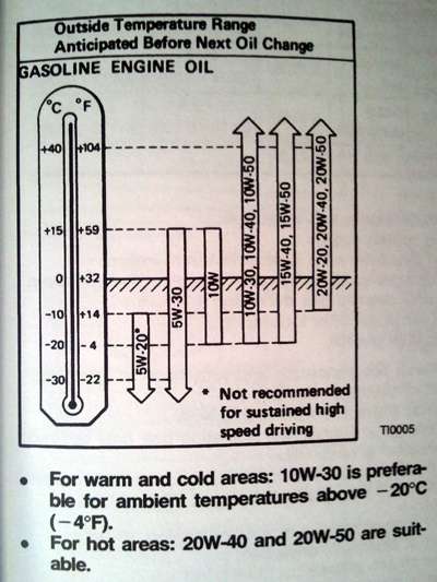

CMF_chargeR » CMF Member VIC, Australia Member since: Posts: Mar 4, 2012 #6 From the factory manual: Unless your engine is heavily modified just pick the viscosity appropriate to your climate from the figure above. I use a 10W-40.
CMF_Welshbob1964 » CMF Member United Kingdom Member since: Posts: Mar 4, 2012 #7 Thanks for that its a real useful chart, alas my old girl didn't come with her hand book. Cheers

CMF_matt.d » CMF Member gravesend, kent, United Kingdom Member since: Posts: Mar 25, 2012 #9 had a look at ebb dude micra mod thread for extra bph and hes using 5w 20 oil but nissan says its not for use sustained high speed driving
