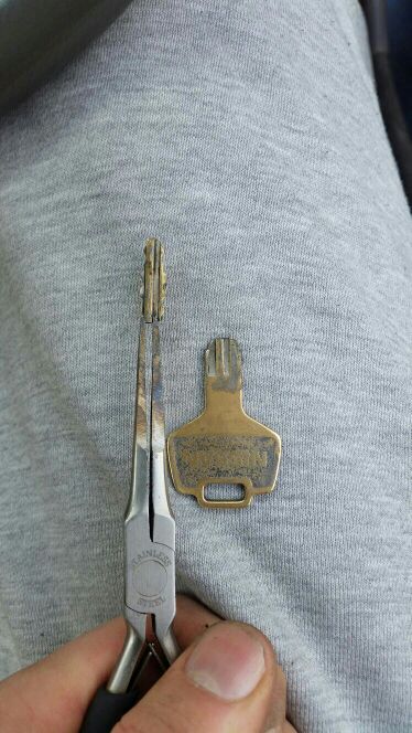

Also, any tips to extract half a key from an ignition? It's a March so I know for fact that the ignition and door barrels are different from domestic models so changing won't be as easily done
Sent from my SM-G900F using Tapatalk
earthing the coolant sensor would diagnose any sensor/gauge fault (it should shoot to hot) and you can remove the inner barrel on most ign locks

In other news managed to sort this so hopefully get a key cut tomorrow
notice the already thin pliers ground down to give more room in the ignition :D

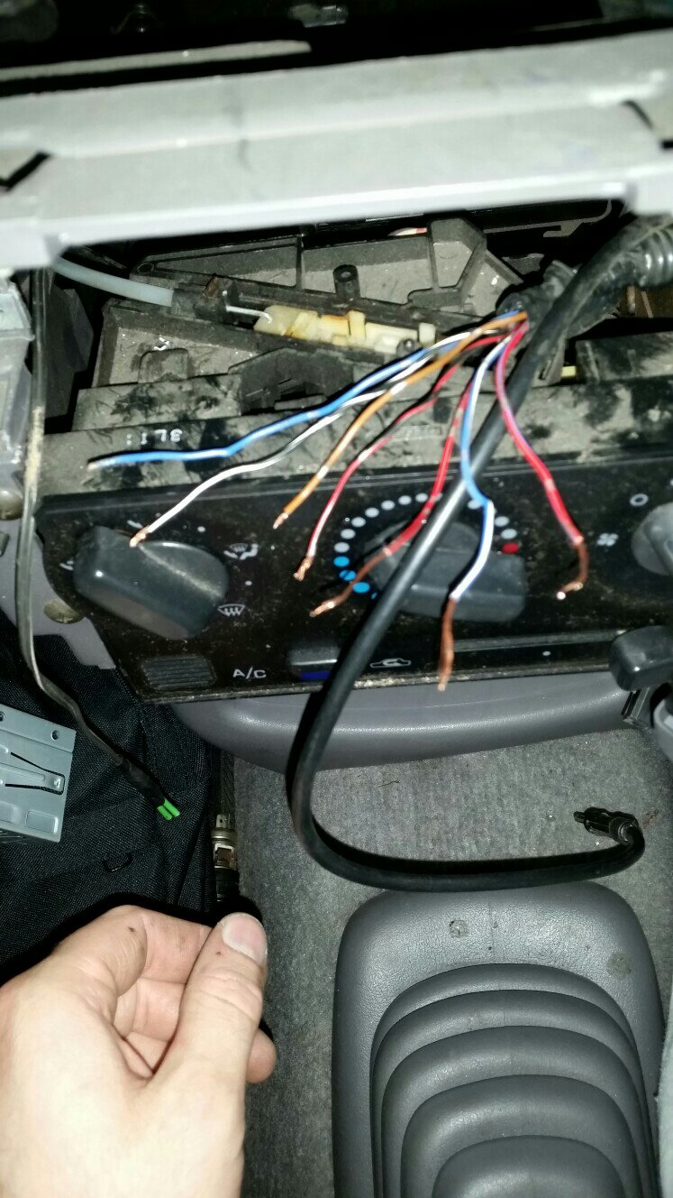

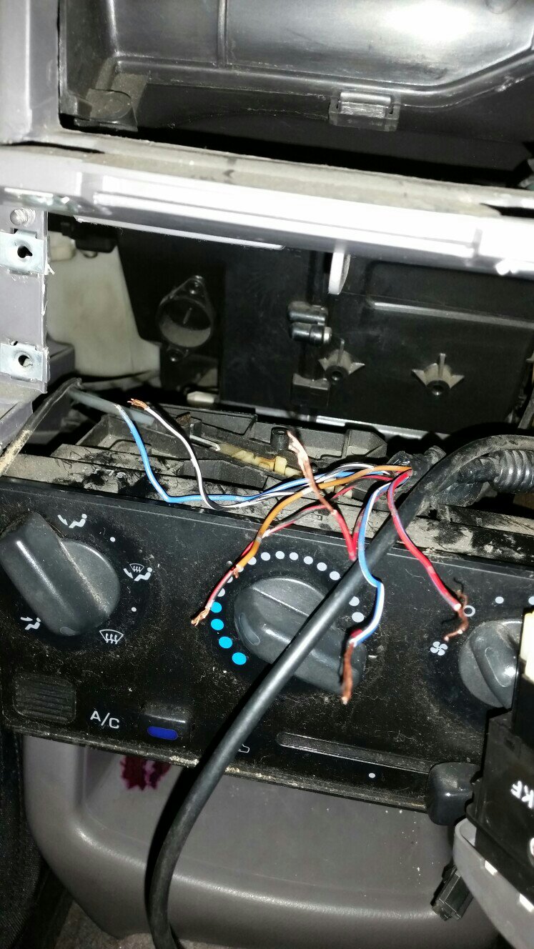

I traced the wires behind the stereo also and only one of them I don't know it's origins. Most are speakers/tweeters despite the car coming from factory without them
Sent from my Nexus 7 using Tapatalk
Okay so nearly at my wits end with this coolant issue, behind stereo lead to nothing just exposed switched live wires which are now covered over.

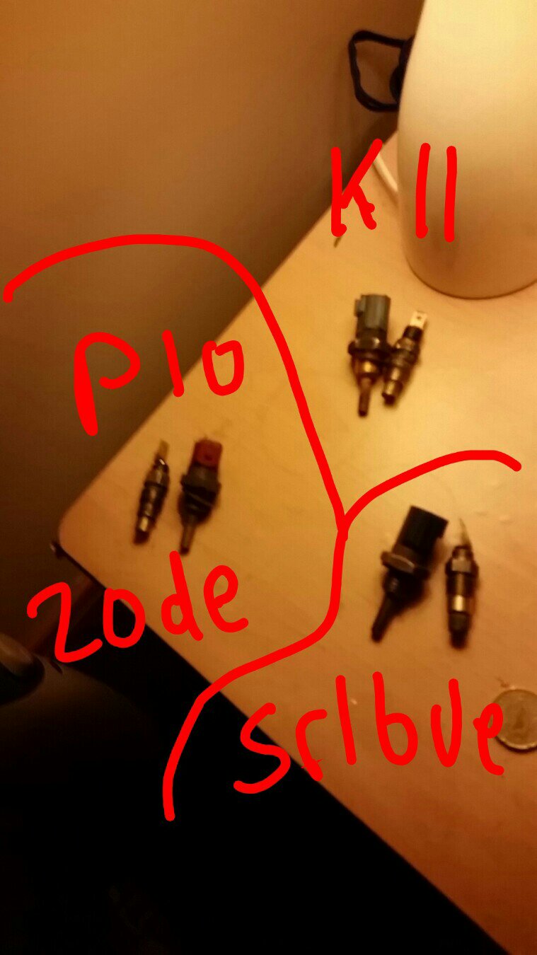

Excuse the crude snapchat picture/drawings. These are the spare sensors I have in the parts bin. The K11 sensors are the ones to come out of the car originally.
Okay swapped in Japanese sensors to see if they want to play ball and no dice it seems, same old story driving to college this morning
