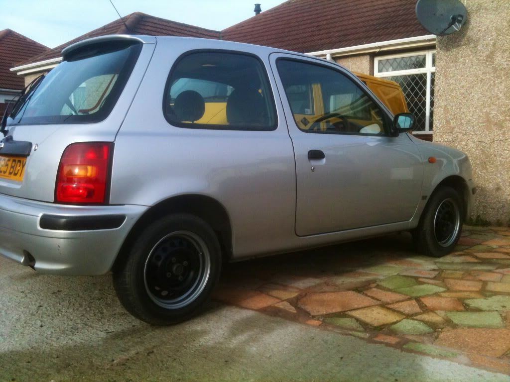

how low did that get you mate? what size of wheels are you rockin with what profile tire i have 13" alleycats with low profiles on them im lowered 35mm and the arch gap is rediculous, could you upload a photo of yours?
Before
After
It measures 12inches from the center of the wheel to the wheel arch. Wheels are standard steels with 175 on the rear and 155 on front.
There is a bit of a gap between the tyre and wheel are but the pic doesnt really show it well
Before
After
how much coils did you take of the back bud?
If I remember correctly i firstly. It off the tightly coiled coil which didn't make much difference so i then cut off 1 whole coil after that.
Best to do a bit at a time tho coz the above is only from memory ;)
