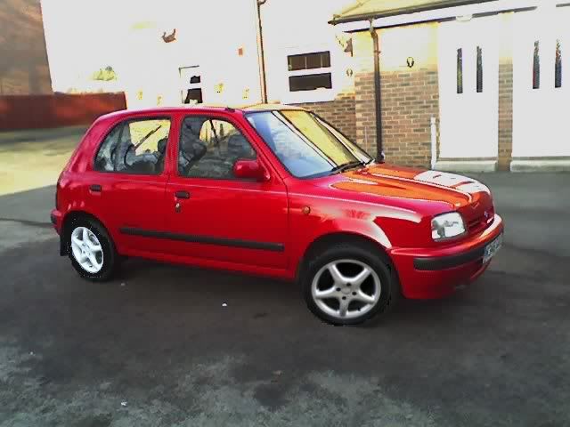

I may have a chance of some TSW 5 spokes from a mate off his civic crx. will the offset of them be ok for my micra?
He's not entirely sure of the offset, the pcd is 4x100 so thats ok.
Bought the wheels off my mate for £100
Not sure if they are exactly the same as the one in the pic but they are very very similar.
they currently have 195/50/15 tyres on though so I got 4 185/45/15 from mytyres.co.uk for £124
would someone be able to photoshop them onto my car to see how they look please?
that's the only side on pic I have of it, if it's too much trouble to photoshop them on then don't worry.

The centre bore on a civic crx is smaller than on a micra. but when i took the wheels off my bro's crx all i had to do was knock out the old adapter for the centre bore and replace it with an appropriate one.
hope this helps

oh got the spigot rings to go aswell. do the old ones just knock out and the new ones just knock in? or do they have to be bonded in somehow?
Thanks people
The centre bore adapters are a press fit it is as simple as knocking one out (stop giggling children) and putting the other back in.
195/50 tyres are fine if you can put up with the speedo being out. I used to run 15's with the same tyres and it was lowered 35mm and i had no problems at all.

thanks mate. I have got some new 185/45/15 tyres here to go on, but if the 195/50's won't give me any problems then I don't need to hurry to get them changed as there's loadsa tread left on them.
