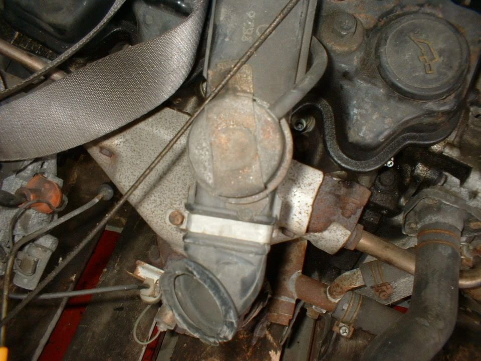

trevor, i think your airpan has an automatic one of these (like a circular sensor thingie on the "Snorkle thingie")
I bought an MA12 last week and it had no flap, just some sort of sensor on it...
You clearly cant see it so you probably dont have one!
EDIT: Something like this, this is my MA12
Yup, both my car an my girlfriend's car have that! They both also have a vaccume line that attactes to it (and goes to the carby, I think).
Thanks for the pic, cleared every thing right up!
only the ECC equiped car's have the auto one.
every other model (which is most) have a flap. Eithe way, it wont make a difference to your problems
