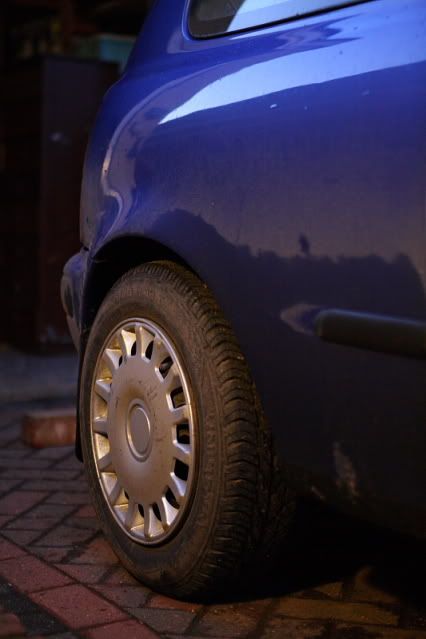

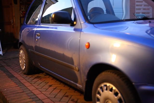

All cleaned up :) I'm very happy with the way the back end sits now, especially with the the spacers on. Is the front likely to settle any more? I should have measured before and after really. Drives well too, not too bumpy at all and less rolley through corners.

What size spacers did you use?? I got some 10mm waiting to go on mine?? Did you do front and rear or just rear??
Fronts are 5mm each side and the rear is 32mm each side :) I'd like to go more on the front (probable to 10 or 15) but apparently it affects the steering.
Looks nice mate. Really fills the arches out. Just checked mine and they are 20mm not 10mm
Was it easy to fit the longer studs?
I didn't this time round, they just screw onto the existing ones for the back. Then a metal spacer fits over them. For the fronts, I only used a 5mm spacer so I didn't need the extended studs. On my last one I used 20mm at the back and fitted longer studs. Was easy to do.
agreed it messes with your steering. even if you don't notice a huge difference in steering feel, its putting loads more stress on the hub ball joint, track rod end, strut leg (i have seen similar design strut shear at the mounting point), as well as putting more static load on the ARB and drop link.
