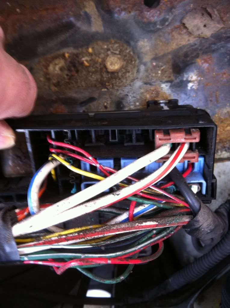

Hi, I have unclipped and turned over the fuse box,the wire top left is the problem one the connections are rusty and overheating etc,if I am going to try and cut the wire and put in an inline fuse bypassing the fuse box (for this one connection) to which wire do I connect it to.Please advice.Tartdog.
yeah but the 4 wires you can see on the left hand side,the top red one with 2 grey bands is the corroded connection for the left headlamp,the red one below with 1 grey band is the right headlamp,the yellow one is the alternator,and the orange one say "inj"?? I've got those 4 wires going in but cant see any wires coming from those connections.If you see the loom? (left side of picture) you can see the red (2 grey striped) wire go right across and go into the right hand loom?,it then somehow comes back out of the right hand loom and into the corroded connection,I obviously need to cut it off as it goes into the corroded coneection but to what wire do I connect it to?please anyone futhur advice,cheers.Tartdog.

ti looks like the big blue/white wire is feeding the 4 fuses (from your pic) and the 4 thinner wires come from each fuse tartdog ?
if so... you need to tap into the b/w wire and join it to the affected thin wire (via an inline fuse)
Right I think I am following you, I pull out the red wire that is connected to the corroded part of the fuse and join it to the blue/White wire at a point prior to where the blue/White wire goes into the fuse box, with an inline 15 amp fuse.If correct how/what type of connector would I need to go about splicing into the blue/White wire?,cheers.Tartdog.
yes mate, personally i would shave a bit of insulation off and jab a spike under about 5 or 10 of the copper strands, then thread the jump wire through and solder or crimp
