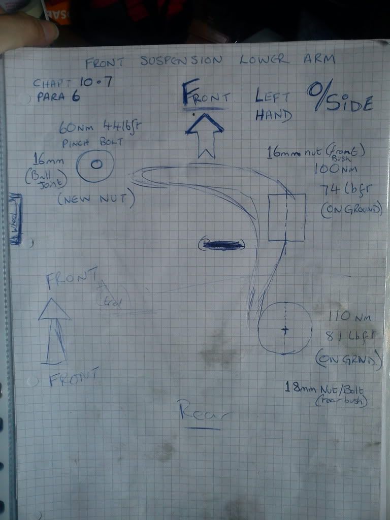

I'm pretty sure my dad made a quick sketch for reference...i'll try and find it and take a phot to upload...might help you further ...

here's my dad's quick sketch...not sure if it will help...I couldn't get a clearer shot :(
