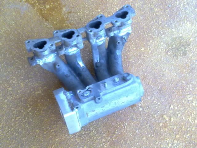

What i was thinking was to weld the trumpets into the chamber so you can the have a MAF on the end to take readings from, bascially a metal airbox.. your other benifit is that you then have a vacuum for your brake servo....

i agree, if you have a 90deg bend plenum you may as well use a single t/b eh, it needs to be like a 4-2-1 design really :)
