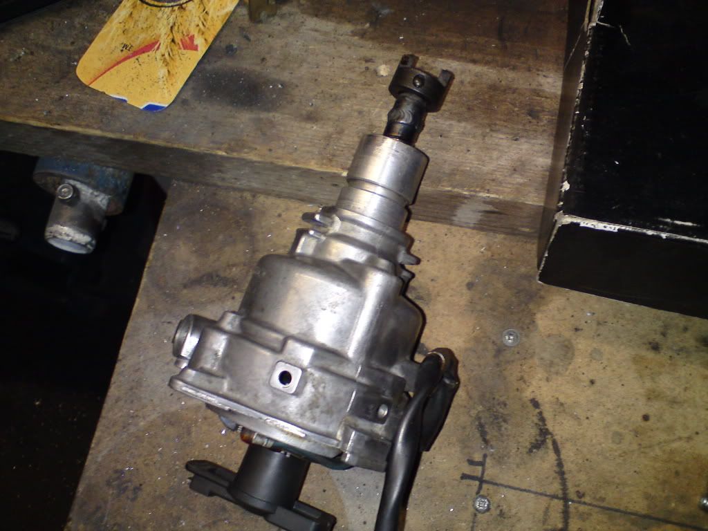

  • Lastly - How do you solve a problem like distributor? I've read the above blogs but i only see reference to Machi San using an adaptor made by Superls, and BiAS has a homemade one but i only see it in the engine in situ. I'm guessing this pic sort of shows what i need to do?
Weld the end of the CG10 Distributor onto the MA10 shaft (black bit at the end)? Is that a precise length, or should i just get it roughly right? Lol.​
What about wiring? Will this work with the K11 ECU?​

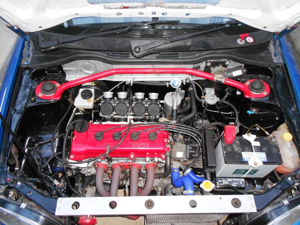

  • Has anyone done carbs in the K11, is space an issue? Looks to be a lot more room in the K10.

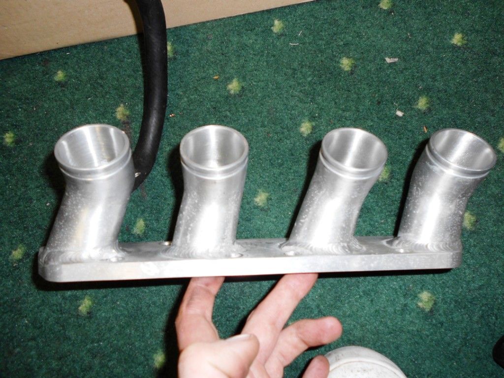

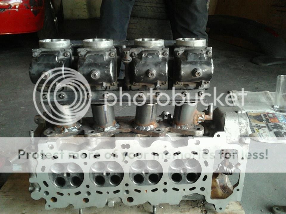

  • Lastly, below pic...what kind of welding is this? Looks very MIG-like on our manifold but i though it was Aluminium. Hmmm. Optical illusion?!
Manifold was made from steel, cheaper to work with while i was figuring out where everything was going to go, have a copy being done atm in aluminium. cbr600 carbs will work fine, they WILL have to have the jets drilled out in order for it to run anyway right. I would start at 1.5mm and work from there. As for the pump, use the pump from the bike the carbs came from, most hondas run a small electric pump. Failing that, a facet red top pump and a fpr set at 4 psi (get a gauge to measure this properly) will get you in the right range. Ignition is more tricky, modified k10 will work just fine, i have used one myself with no issues. For even better spark control then the megajolt jr would be your best bet. Google it and see for your self, its mappable and would be far more effective in the long term
Nice advice mate. I'm going to also make my out of mild steel also, can't weld alu atm! Lol. Reason i ask is because it looks so damn similar to our manifold, usually people just fire something together, hats off sir!

Just a point for fitting them in Rev if you still wish to run a brake servo you will need to canter the tubing to the nearside in order to clear it. :)
Yeah mate, good advice that...i've had that problem with my throttle bodies already! :( There's also a power steering thing in the way of mine in think. Had my TB's in my white micra and i moved them to my red micra i was like WTF!?!?!?

I carnt take the praise for the mani bud it was made by Bogg brothers i just gave them the angle/measurement to clear the servo lol They did a real neat job they matched up the alloy with the inlet ports exactly so it fits the head perfect: (sorry for the big pics)

i had bike carbs on mine, cbr600 from around 96-98 ish,
as for distributer, i machined an adapter to fit a k10 dizzy in a k11 engine and modified a k10 dizzy to fit
