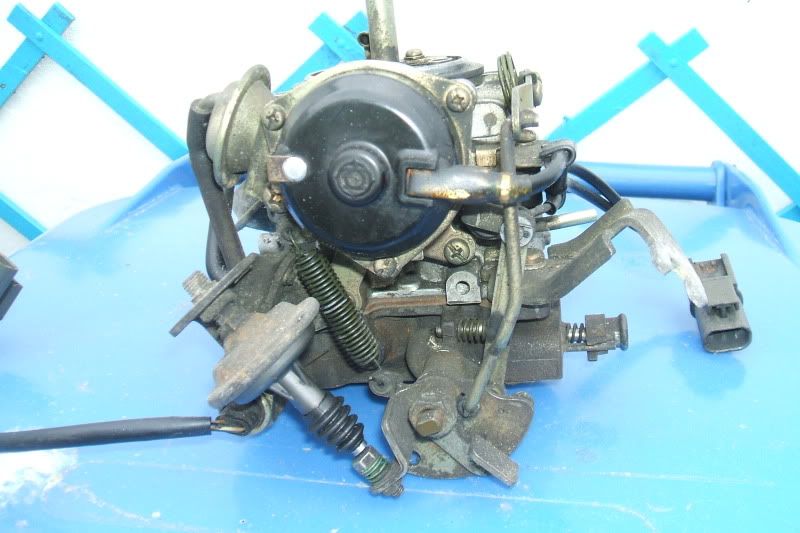

I have one which is off of a GSX 1.2.

micra 110; that's from an 1.2 automatic isn't it? Looks like you have a dashpot on the back of it, i'm affraid dorset is a bit far for me to come since i'm up in leeds area, thanks though.
