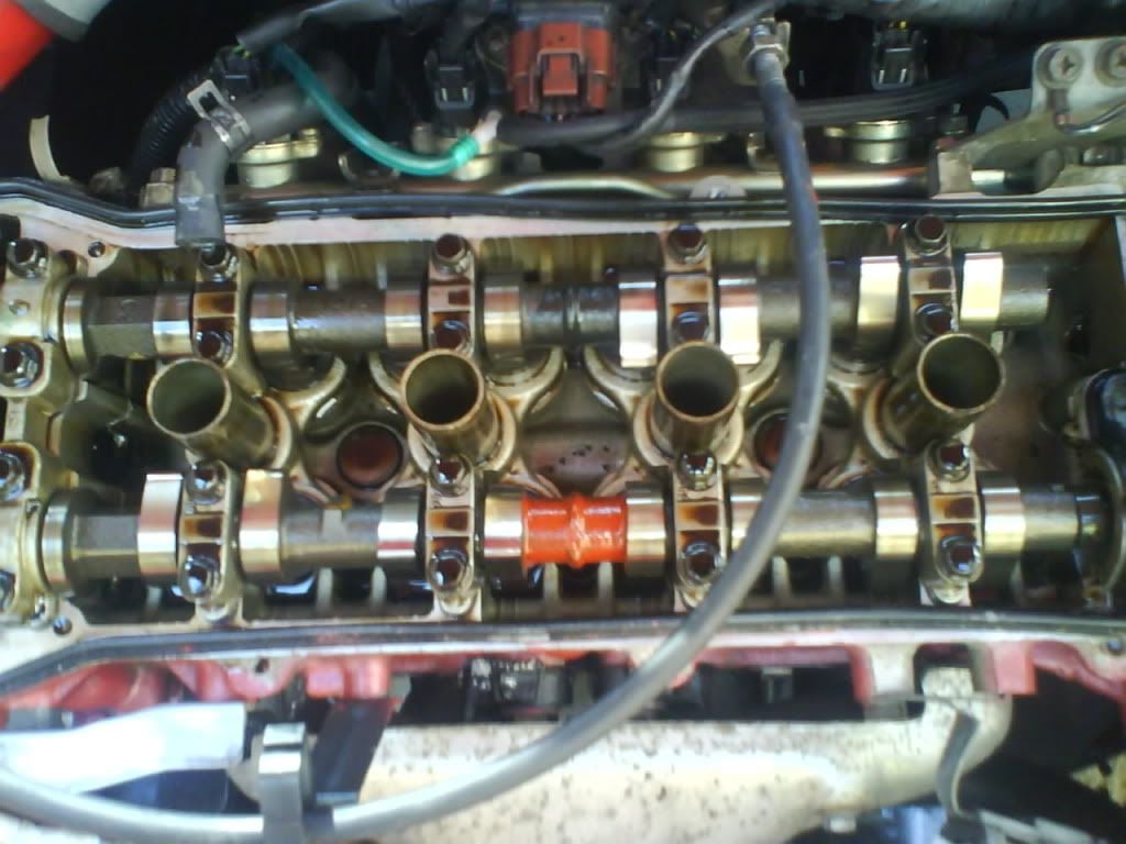

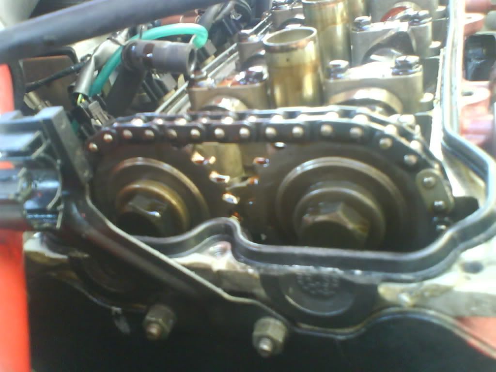

But the 1.0 that was in before didnt have nats? And surely it wouldnt matter if the 1.3 did as i didnt use any wiring from it? Im starting to wonder if its the cam timings now, as the cam cover bolts where loose when i changed the covers over. . maybe somebody had been in there and thats why it was in the scrappys eh? trust me to pick the only duff engine out of ten micras! If i post a picture of the chain and top sprockets, would people be able to tell if they where out?

Make sure that cylinder 1 is TDC on the photo. If you've had distributers off or moved, it's important that you check the ignition timing, as this will MOST LIKELY be wrong.
I took these photos before i read that post:(, i can take some more though as i dont know if is tdc in the pics. How would i turn the engine over to get it there though??
Sprocket side. .
Full cam shot. . .

it's difficult to tell without 1 being at TDC.
you can turn the cams by hand with a spanner on the hex section, or you can push the car in gear to do it.

Unless you've had cams off or the chain off, it's highly unlikely they'll be out of time.
