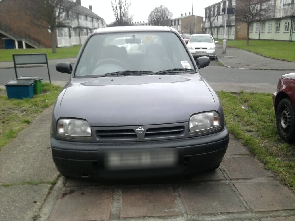

T tryme Feb 19, 2012 #1 you can slightly see the ding in this picture on the drivers side. theres one to match on the passengers side to now. would it be easier to just replace the bumper or can it be repaired by me at home?
O Optima Feb 22, 2012 #2 pour boiling hot water on it a few time and see it go back to the shape it was. Plastic have memory! And remember the shape it was moulded in!
r-reg-sr ------- Site Supporter Feb 22, 2012 #3 remove bumper and do that,,helping the shape push back out
