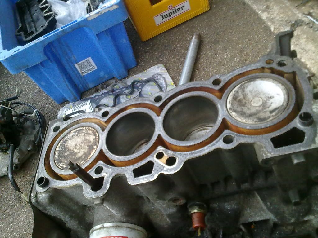

Ive got a dave walker stage 4 head, an 1986 ma10 with unknown millage (hardly owt from going on the condition of it!) and a lightened flywheel, will be on bike carbs and a 4 branch manifold too. Ive rebuilt plenty of engines, ones at college and rebuilt 1 or 2 bus engines, but this will be the 1st full engine rebuild that is mine and will be going in my car :grinning:
so strip the original engine:
Bloody clean in there to say it was from a D reg!

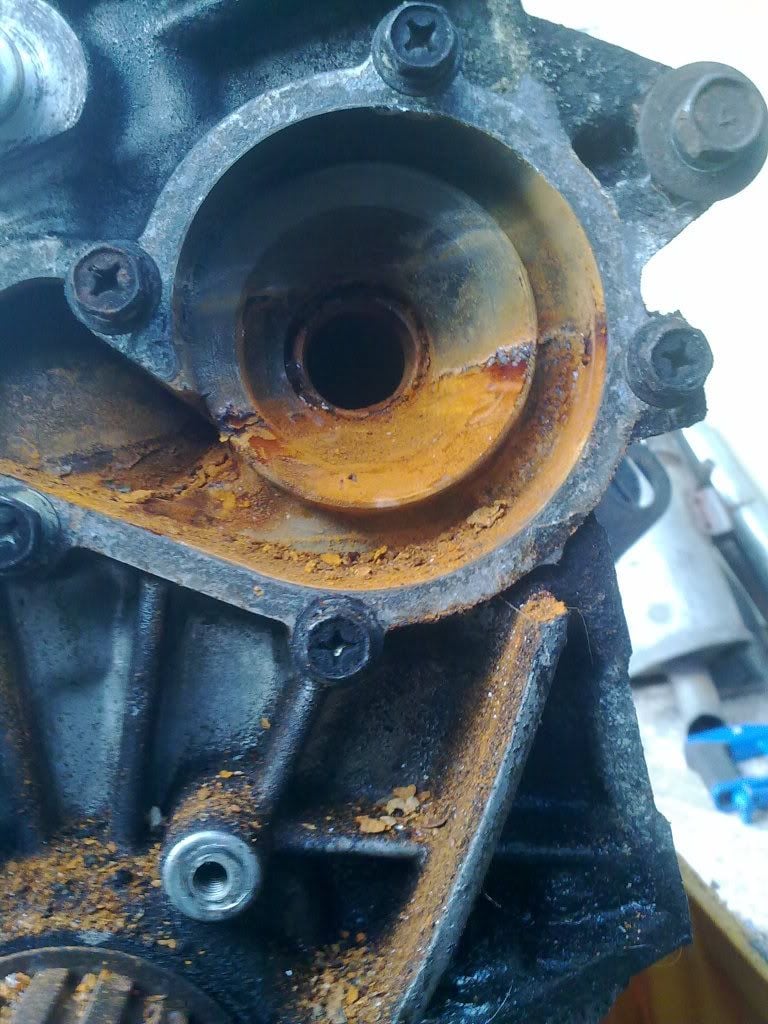

That isnt though, new water pump time:

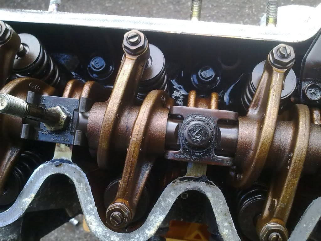

Got the head of too find this:
Its like bloody new still!

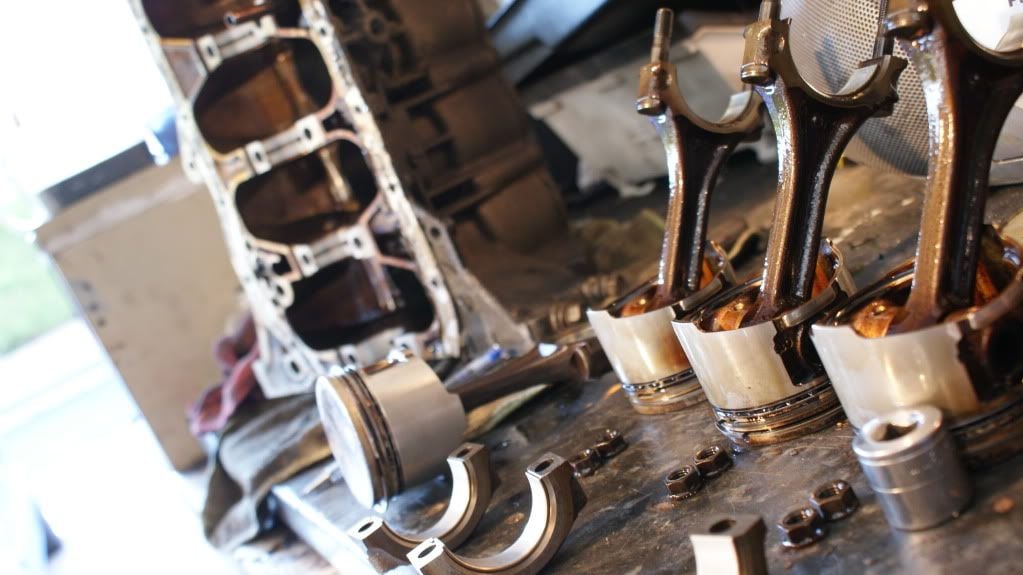

here comes the fancy pictures as my dslr camera came in the post today :D

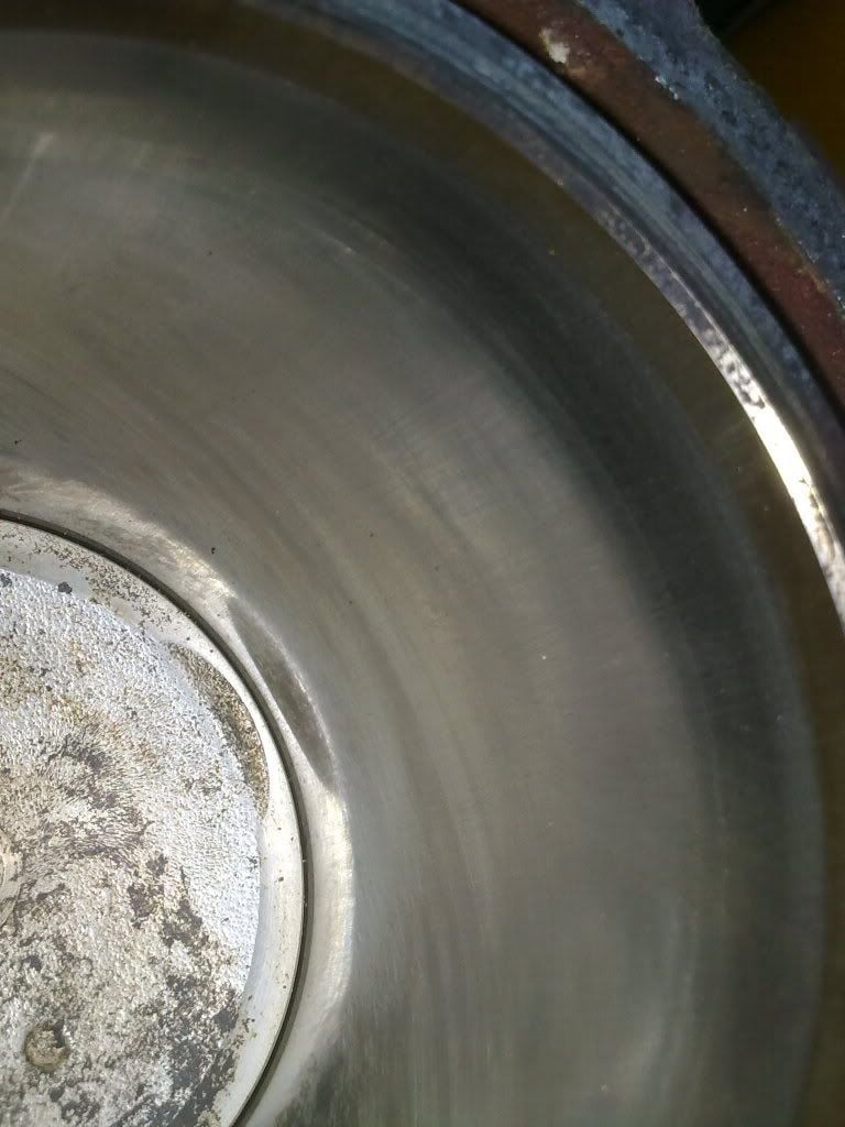

Pistons out of the block:

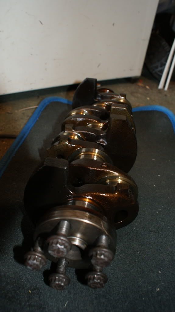

nice clean crank:

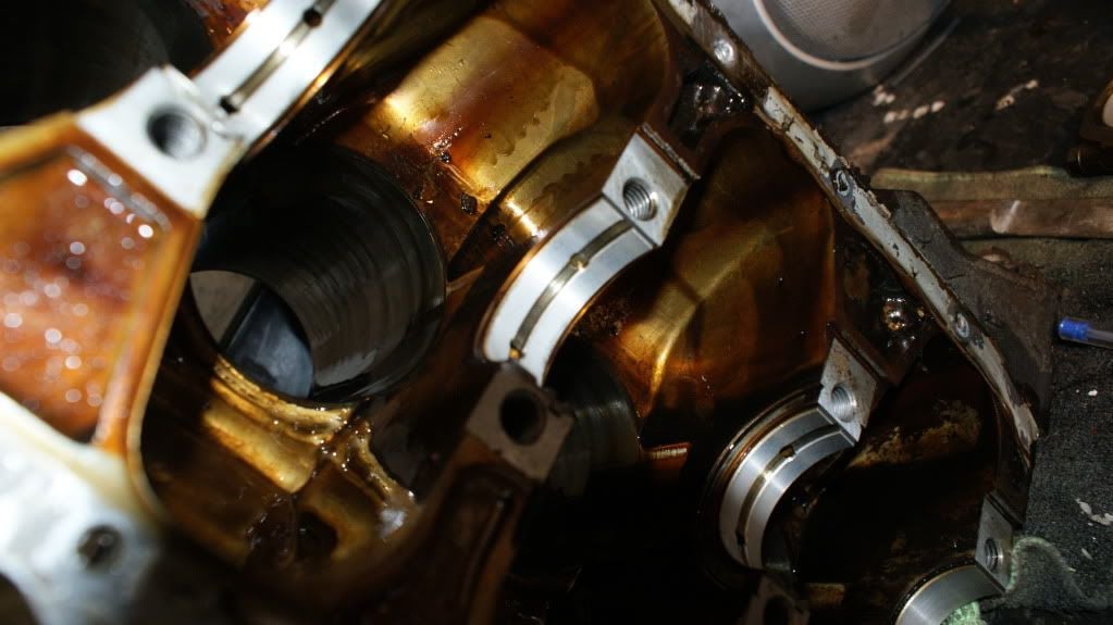

Crank shells in bloody good cond
