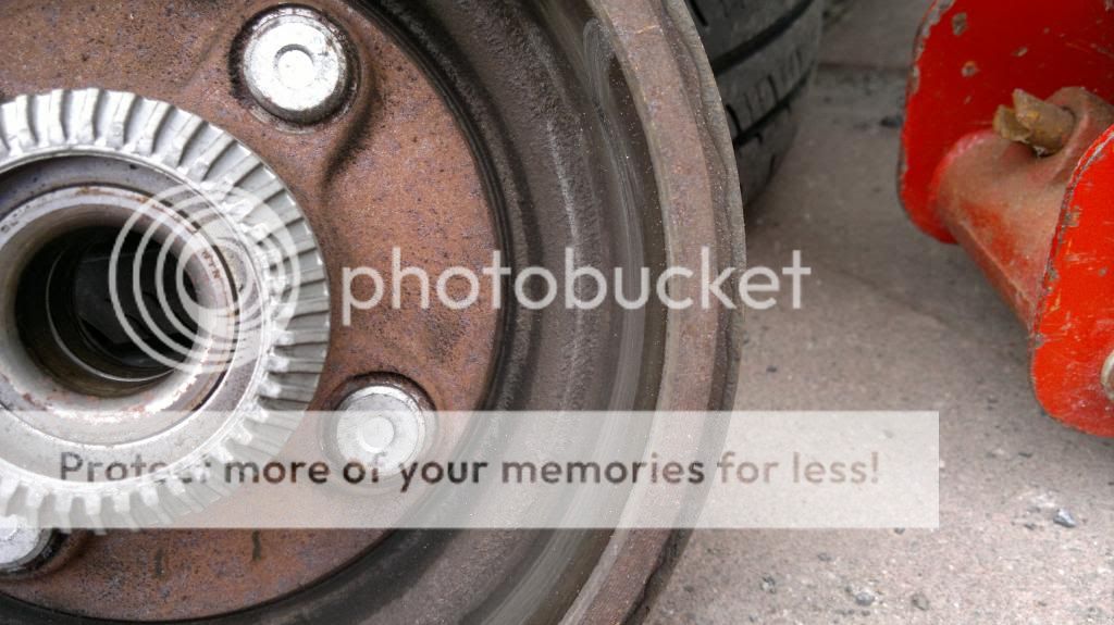

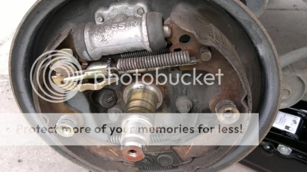

I found these pictures last night, forgotten I'd taken them when I adjusted the shoes in March last year.
The drum itself with the ABS setup on it
that March ABS drum setup seems to be completely different to a non-ABS UK drum brake like on my 1993 SLX.
guess you'll need to order shoes that are specific to the import march brakes.
