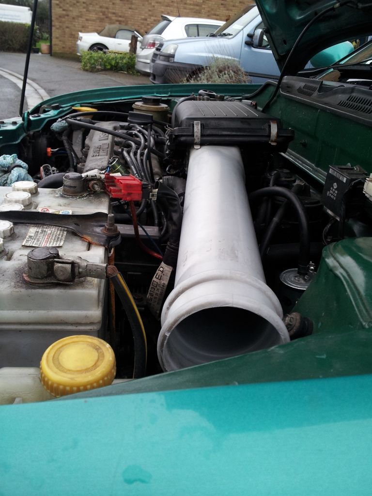

This morning my k&n induction kit arrived (a k11 one off ebay for £12 :grinning:) and about an hour ago I had a go at fitting it. At the moment it's connected and seems to work okay. Thing is, I cant use the support bracket that came with it to hold it in place because there isn't a anywhere to bolt it to, it's just resting between the plastic top of the engine and the front cross-member:doh:
Anybody with suggestions as to the best way to supporting the filter cone? There isn't much room for manoeuvring in there at all.

Been having a fiddle with the damn thing all day, grated my fingers to bits. Decided that during the week I'll do my best to get it under the battery because I took it for a test drive and afterwards the filter was pretty warm...not good. It'll either be under the battery or maybe I'll make a heat shield with a bracket like Shaun suggested. All part of the learning process!
id imagine 'heatsoak' from the manifold is going to kill whatever power gains that air filter offered if you keep it there.
id extend the pipe and try fit it at the same level as, but in front of the alternator so it could be sucking cold air in from the grille... or possibly mount it in between the battery and the abs module?
it looks the coolest where it is now but lets face it, when are you ever going to look at it again ;) you want it where the bhp gains are :D
if any bhp gains were to be had then yeah behind the battery or outside the engine bay is best, like a cold air intake pipe from outside in the grill etc.
I'm going to run this down towards the lower grill in the bumper, and then connect a hose from it to the airbox. We'll see how it goes anyway!
Look at that bad boy haha...
I've driven it to college and back this morning and the aluminium pipe stayed very cold despite being quite close to the engine. The other pipe wasn't so cool, so I'm thinking of wrapping some shiny tape on it...thoughts? And should I lower the filter cone so it sits over the grill a bit more? I was worried about stones flying into it if I lowered it too much??

Well after a week of driving with this thing on I scrapped the idea, and put the filter cone on ebay. It made me very wary when going over speed bumps, which there are loads of where I live. Kept having to check on it every day because it was slowly slipping lower and lower! At lunchtime I basically did what Bombardier suggested, fixed my K&N replacement filter in place and used the air feed to direct cold air to it. It doesn't look too pretty at the moment but I've got some flexible aluminium cold air feed pipe coming tomorrow and cable ties, so no more tape! :laugh:
The filter box and intake tube may also benefit from a coat of reflective paint and/or a thin layer of aluminium/ foil to reduce radiant heat soak.
I would recommend having a small space between the airbox and the aluminium/foil.
This is how it looks now:
I need to find a way of holding the filter in place that's a bit tidier than green wire. I don't want to permanently seal the filter on, what should I do?
Why do you have two cold air feeds? isnt there only one inlet hole? i'm only asking because i'm trying to do a similar job, but using a panel filter upgrade rather than a cone... trying to think of ways to indirectly feed cold air towards the air box intake. thought of possibly taking out one of the fog light plastic 'blank' covers and running a feed up towards the intake. I wont be connecting it directly to the airbox but rather using it as a way of feeding cold air to the suction area. If you can understand where i'm going with this... please could you offer some guidance/ ideas?!! thank you!
Hi, well what I did was take the airbox completely off, as you would to change the air filter, and now the filter is held tightly in place with wire. The air feeds are about 3-4 inches from the filter. My reasoning for two feeds was basically: the more air I can get to reach the filter, the better! (Y)

Intake diameter into airbox is 65mm OD. Just find some piping to fit, route the same way and run a k&n panel filter. Done. Btw, raptor, does your intake pipe have 3 holes in the back of it on the engine side? I just noticed today, thought it was odd. Might block them off.
It has a hole or two along the bottom and then some smaller boxes off to the side. The box on the side of the air intake pipe and the box off to the side of the airbox are both to collect debris that gets sucked into the air intake: the bigger and heavier bits will get forced to the outside of the pipe and blown into the intake when the air gets sucked around a corner, or fall to the bottom and drop out the holes on the air intake pipe. So yeah, you could block them off and probably should to be honest because it probably loses some of the air that gets taken in because it gets blown into the filter compartments. And if the air filter is doing its job, the derbis should be getting stopped by the filter. You can just pop off the filter boxes with a screwdriver then just file the plastic away until the surface is relatively flat and then tape over it or something ....
And I'm probably just going to end up doing something like Nans_Micra did tbh; I have planned it out a LOT more than he did, I'm pretty sure haha :p just get a flexi pipe, clamp that over the airbox pipe, run that to just above the manifold, aluminium straight pipe bracketed onto the metal cover with the bonnet latching mechanism and then to the metal bar just behind the bumper, induction kit behind the bumper wings, heat-shield covering the back end from the exhaust manifold and then bolt that onto the chassis. I mean, imagine where Nans_Micra's induction filter is but slightly lower and to the right ..... would that get enough air to it or ....?
Is that a rhetorical question? And myself and Morcs both have K12s so it's different ........ very different ....... quite possibly the worst car to try and modify because of the tiny engine compartment
i have the standard back on now,was a test. shows i may be over fueling as less fuel was being burned with big pipe.
My main annoyance is that the only place in the front of the engine bay that cold air can get in effectively is the small hole that feeds air toward the alternator . K12s are sealed up pretty good
Exactly, which is why I'm putting it down behind the bumper wings with loads of support struts to hold it there. The other place is behind the battery, but it's miles away from any cold air sources, plus it'd be getting too cramped to try and put an induction kit, heat shield and a cold air feed there, partially because it's so isolated and partially because there's nowhere to attach the brackets too ..........
