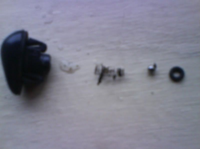

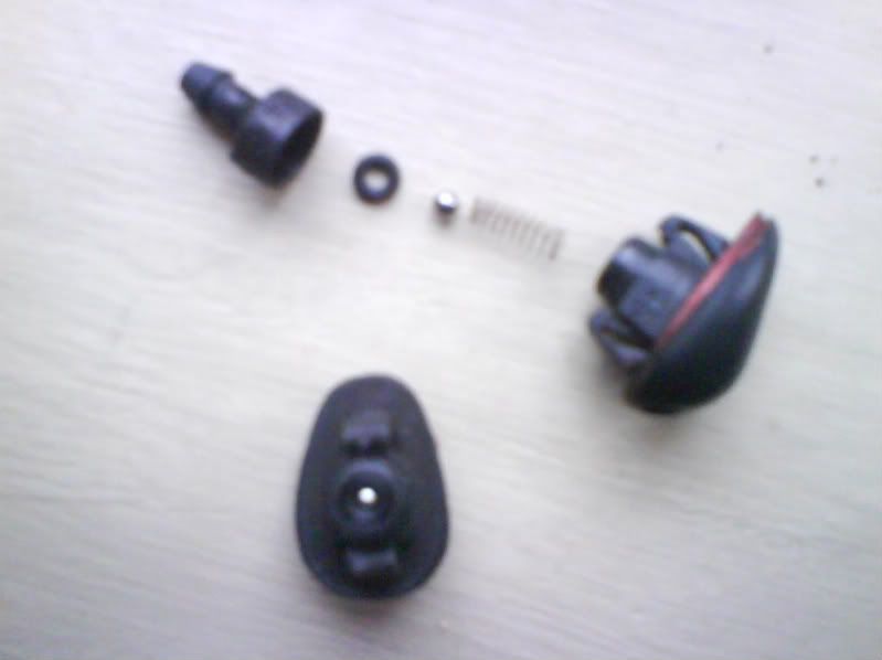

it turns out that these wash wipe jets have springed ball bearings in them,,in other words they have balls
found this out thanks to "superls"(uk micra site)
just look what gets trapped inside these jets oooooohhh
thats not the half of it but the rest will be flushed away in the sink,,,by gently tapping and a small needle through the jet holes

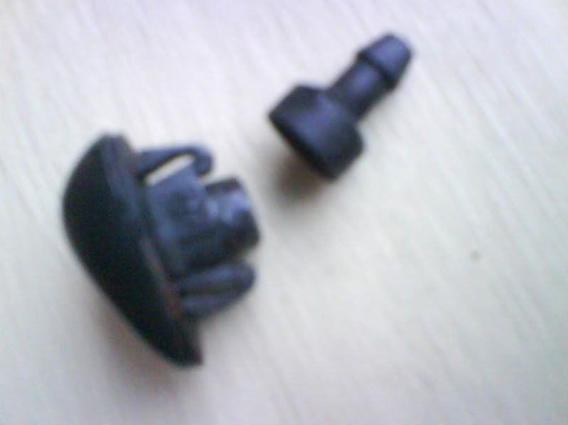

its alright keep calm the cap on the end comes of first,,its glued on but a little heat gets it loose,A LITTLE HEAT!!
what youll find inside
doo away with all the innards , that should keep it free flowing and minimul service require
never use jets in the freeze,,as either the motor blows or pipes come of
