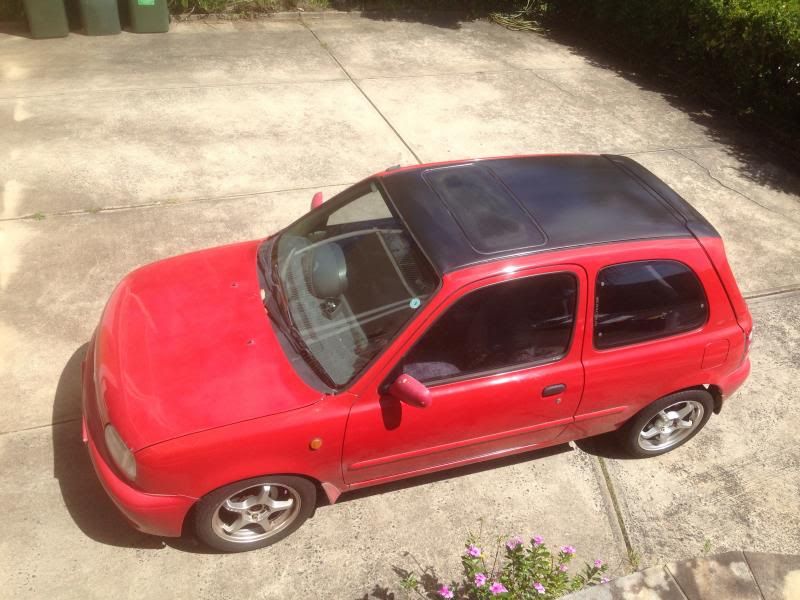

Haha... This is my daily and I'm trying to keep it as "budget" as possible :)
Paint "should" end up something along the lines of this with a black bonnet and dark tints.
Please excuse the dodgy MS Paint Brush effort.

I'm seeing double haha. BigJohn it's looking good. Are you going to follow the line in the body and paint the top of your front guards?
With tint. My old Cedric had factory tint or privacy glass (whatever you want to call it) and I got 20% put over that so it was probly more like 5%. It looked pimp but at night time if you tried to look out the drivers side window. It reflected all the dials. You could see how fast you are going, but not your mirror. So do what you want, I just wanted to share my experience with really dark tint.
CMF_BigJohn
» CMF Member
Member since:
Posts:
Rebelsan WROTE:
"I'm seeing double haha. BigJohn it's looking good. Are you going to follow the line in the body and paint the top of your front guards?
My plan at this stage is as you said, follow the line of the body, painting the tops of the guards black with a black bonnet.
I had a Soarer some years ago with 5-10% tints on it. It was fantastic during the day, but when it came to driving at night in the rain, I hated the tints. I'd have to put down both front windows when pulling up at intersections to see if there were any oncoming cars.
On my Falcon, I have 15-20% and it's perfect for night & day.
