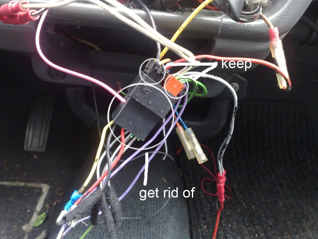

ok, hope these pics help you understand what I mean, because so far you have it totally wrong. let me explain one more time.
ok. i cant see (under the dash) any cables for my rear speakers. you say it doesnt come with rear speaker wires, ok, fine. my question again is what can i do from the car end of things, to be able to have somewhere to plug my rear speakers from my HU into.
It has to be possible to connect rear speakers, but how, if you dont have the right wires coming out of your car?
I hope this is more clear, here's some pics.
http://s972.photobucket.com/albums/ae205/Daan84/

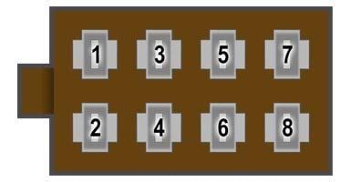

first i would disconnect the big plug end put it away, it's just a plug from a radio which got cut off by someone. the two smaller ones are important (brown and black). The black one is for the power. Important for you is the brown one. That is for the speaker signals.
1:right rear +
2:right rear -
3:right front +
4:right front -
5:left front +
6:left front -
7:left rear +
8:left rear -
hope this is what you wanted to know. you only have to install new wires to the rear and plug them into the right place at the plug. then put the plugs, power and speaker, into your radio

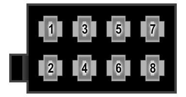

/edit: I think it helps you if i upload the other plug layout too. you will know if all wires are connected then
1: speed signal (unimportant)
2: telephone mute (think it's also unimportant)
3: empty
4: battery + (important)
5: remote (only for a amplyfier or something like this)
6: light signal (don't know if you need it, i don't need it for example
7: ignition + (important)
8: ground (important)
so if there are wires at the 4th, 7th and 8th pin everything is connected

thanks for your help alleks, shaun ;). but what i did was cut everything off, the whole harness. works perfect :) thanks for all your advice anyway ..
