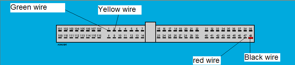

I've looked into it before and it looks pretty easy if your confident with a soldering iron tbf. If you want a hand working out what wires go where i will be happy to help because i worked it all out already because i really want one :p.

And yes I would absolutely love the help mate :) thanks

That's how the Bee r wires should splice into Micra ecu harness. Checked on autodata to find pin outs of the ECU and they correspond with what Bee r say. That is looking at the wire side of the multiplug going into the ECU. Would help if i knew the colors of the wire going into the ECU so i could tell you the color of the wire you should be splicing into. Ill have a look tomorrow so i can tell you exactly what wire :). Personally id go with soldered joints because they are more reliable and look more tidy but crimps would be good enough.

Silly question. Did you use the same pins as the ecu photo above, also what is your gain set on as im having trouble getting it to bounce like yours is.
Hi yes I did,
first question, do you have any catalytic converters in your exhaust system? also, for flames i use gain zero and the lowest revs possible, but for launch, use highest gain at 3000 rpm
