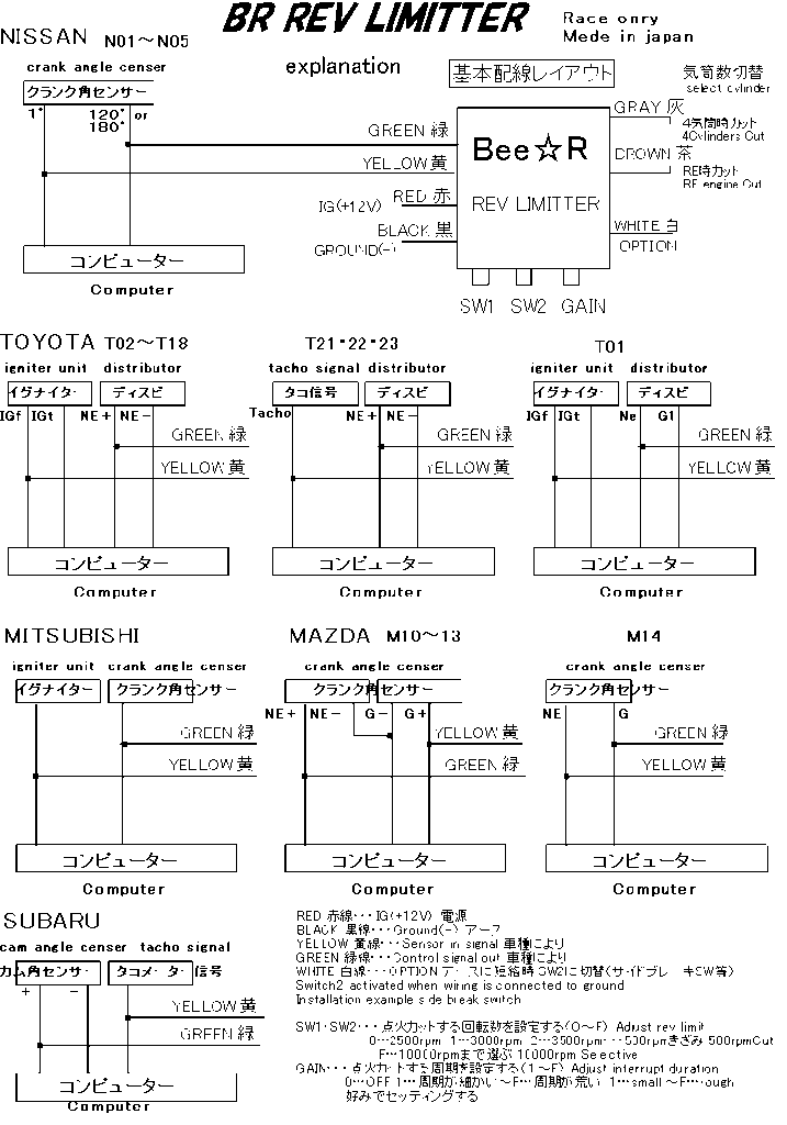

jamier2007 Ex. Club Member Jul 7, 2015 #1 Has anybody had any experience wiring in a Bee R. I used the diagram that Scott.c put up but that didn't work, I also tried a few other wires from the ecu which are meant to be cas signals.
