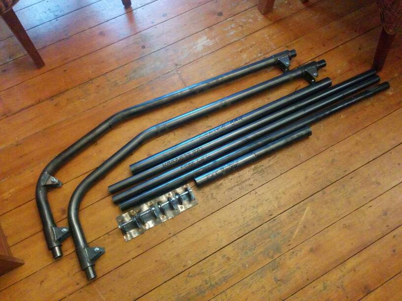

I went with a show cage for the pickup, but I will be losing the brackets and welding all together.
Plus I can add a front section and door bars if I want to go full Monty.
