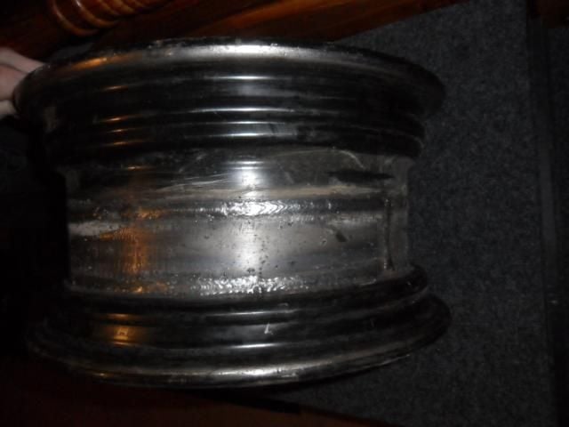

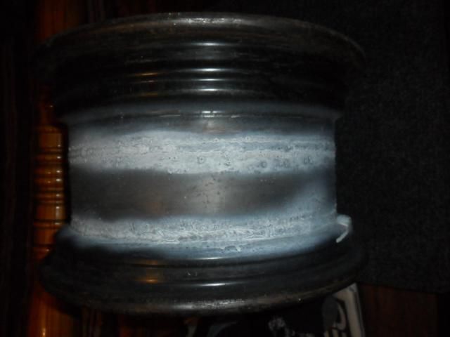

8 1/2 j rears 7 1/2 j fronts 14" thats a 3 " band in the rear 2" in the front vw polo 6n coilovers fit with not that much modification when lowering you need to fit make buy an adjustable pan hard rod to centre the rear wheels when lowered into the weeds lol
have a look here this is how pork and myself did the polo coilover mod the steels i got banded localy by a vw guy cheap n vvv good quality rims
