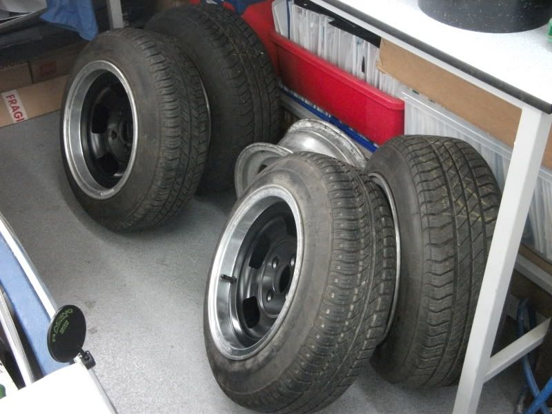

Here's a few tyre size examples from my archive.....
155/70 on 6
175/60 on an 8
155/70 on a 7
165/55 on a 7
165/55 on a 7 (front) 165/55 on an 8 (rear)
165/55 on L to R 8,7,6 middle one is an accelera, either end are nankangs.
from the other end
165/55 on a 5"
