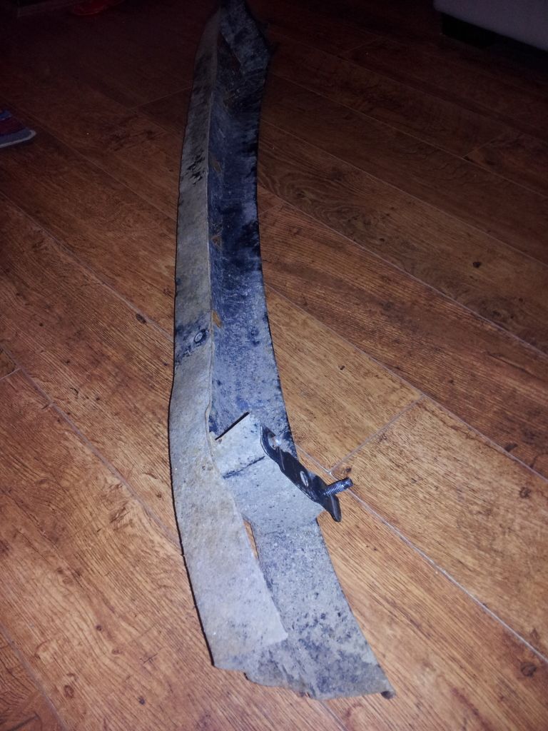

I noticed a set of rules for f1000 rallying that said it is legal to remove the 'brace bar' from inside the back bumper. I have mine out and it weighs 2.3kg so it's a worthwhile no pain weight reduction.
I just wondered if anyone can give me good advice on how best / neatest / simplest / cheap ways to re-affix the bumper to the car when it's gone. The only two fixings I have left are the front upper ones, vertical in the back of the rear wheel arches.
Obviously 2 of the 4 bolts sheared off during removal too so it can't go back as good as new already.
i removed the bar
then cut an inch each side of a pair of studs
then put that 2" bit in the middle of the bumper.
put the bumper in place, then drill 2 new holes in the car for the studs.
attach with the studs and corners (cable ties!)

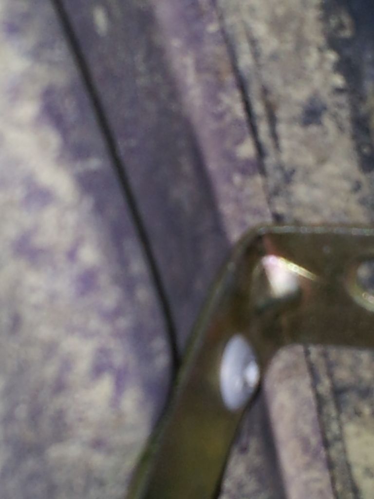

WDID Pop rivet 2 angle brackets about 75cm apart either side of centre into the wheel well area iirc. Then 2 self tappers vertical down into them along with a tie wrap at the back of each wheel arch. Reduction about 2.3kg minus new bracketry of course. A bit wobbly and nowhere to fix at bottom but not fell off yet! First real test = next event.
