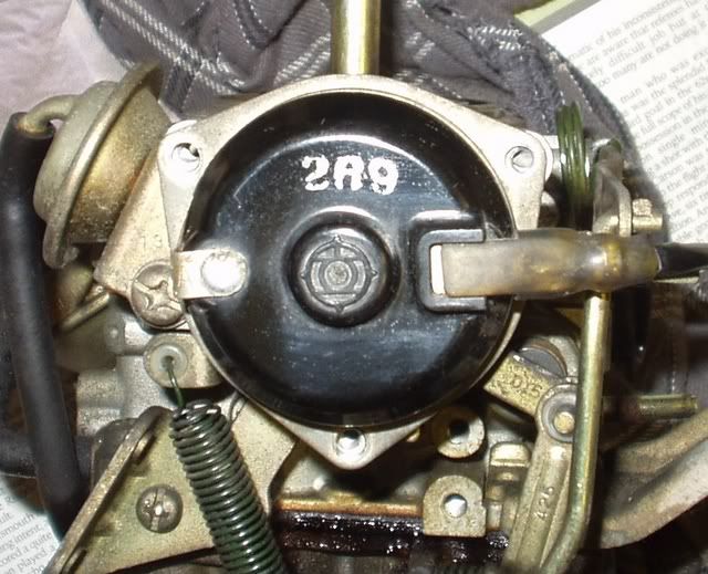

I had to remove the Autochoke housing on both to do the soldering.

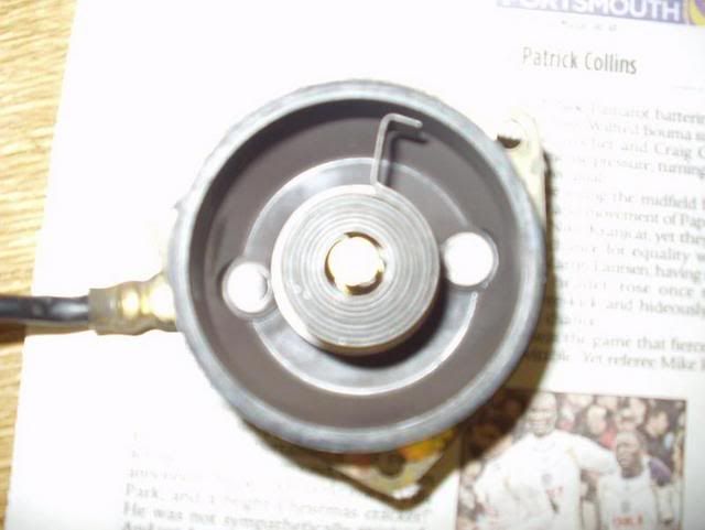

Autochoke Housing.....
There is a Spring in the Housing that goes 'twang' (Long sticky uppy bit) when you take it off...does it not? :laugh:

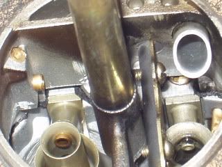

Photo of Autochoke in it's set position on Notch 2
Butterfly Closed...

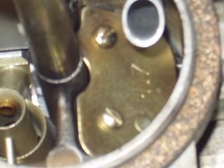

....and when Throttle has been applied....
Butterfly open.....
Now here's the BIG question.....
Does the 'Tang' (Sticky uppy bit) on the Spring, sit in between the Levers at the top?

The spade connector is pointing to the O/s (changed from N/s), when you say preload, does that mean..er..i'm having a guess at this :blush:...like start the spade connector at 12 o'clock and going anti-clockwise right round to 3 o'clock to give the Spring some Tension that way ....??? The spring looks a little flimsy wouldn't wanna snap it! i wouldn't know where to get a new one either! lol!

yes 3 oclock i think, its bimetalic innit, so as it heats up it winds the choke flap open ?
mine was wired to the alternator so it was,nt fed with the ignition on, but was fed with 13v as soon as the alternator fired up
