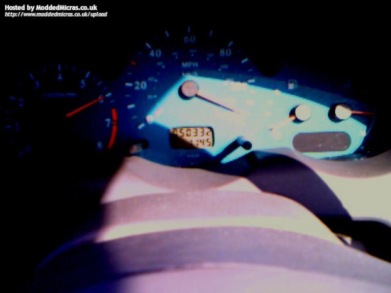

1.0 + 1.3 cams + decent air intake + big hill on private road =
C%3A%5CDocuments%20and%20Settings%5CRich%5CMy%20Documents%5CMy%20Pictures%5CPhone%20Pics%5C115.jpg

EDIT: that pic rlees isnt loading:(

that picture is jus my speedo reading 117mph lol
Picture:
