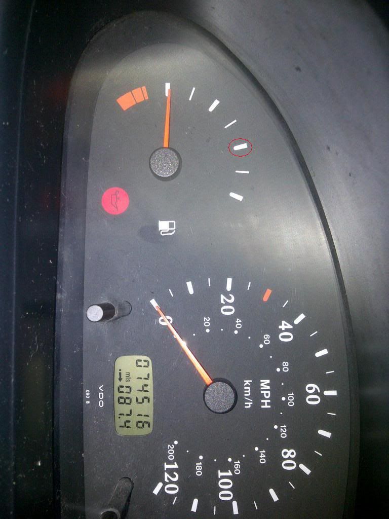

Here is a photo of my fuel gauge. I put in £30 or 23 litres where it sat on the line marked with a Red circle. The display shows i've done 87 miles using that much fuel. That's no way right in my opinion.

You can't accurately know how much fuel you are using unless you used full tanks. Fill it right up, reset your trip meter. Next time, fill up again and then calculate your fuel usage. Unless you do that, you are just guessing.

I understand it would make sense to go off a full tank but getting 70 miles to £14 is bad and putting in £30 and it now almost sitting on the Red after 99 miles (todays driving)looks very poor to me. At the rate it's been dropping i will only have another 20 or so miles to go before the low fuel light is on so that's roughly 120 miles for £30. Poor no matter how you look at it for a 1.0 litre engine.
As mentioned above, i was getting more than that to about £20 with a 1.8 200hp engine.
