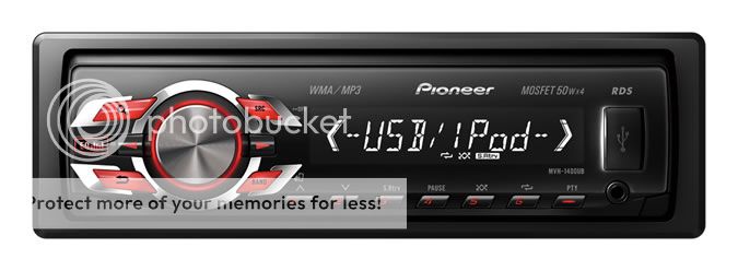

i have a 1997 micra gx
i bought one of these pioneer the other day
My ice consists of
pioneer 2 pre out head unit
1000watt fusion amp
1000watt fusion subwoofer
450watt wiring
problems
1. i have connected my 12v red wire to the battery but no power is getting through the wire when i test it?
2. the remote line from the head unit to the amp, does this connect to the remote control wire off the head unit or aerial?
3. earthing the amp do i need to earth anything else?
thanks
I have that headunit, good when you get used to it :)
With regards to the 12v have you used a continuity tester?
The remote wire can go into any power source that becomes live when the ingnition is turned on, but I believe this unit has a blue wire labelled remote.
No you only need to earth the amp, I used the seat mounts :)
Yeah i find it great for value for money.:)
