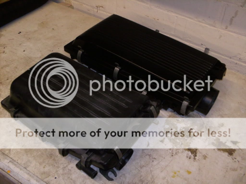

does it look like this (bigger one)
I'm not too sure, I haven't seen it. He told me he was breaking one so I asked him to hold onto the airbox and breaks. I'm sure it was a 1.8, but I only assume so. I'll find out for sure. Are the breaks the same on a 1.8 as a 1.6?
1.8 airbox will not fit. Only 1.6 and 1.4 GA engine arboxes will fit.
