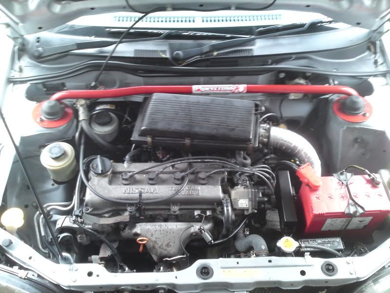

I bought my 1995 1.6 almera airbox off ebay..it came with just the box and air filter................In any motor factors you can buy 60mm diamiter silver ducting pipe wich is big enough to clamp on the end of the almera air box and source cold air from either behind the battery or beside the radiator.
Here is a picture of mine fitted.
