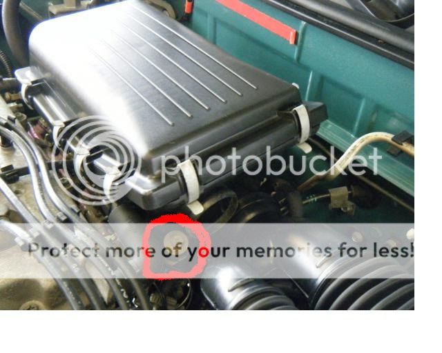

remove the existing cold air feed pipe, there are two screws holding it in place. Ones under the coolant reseviour andf the other is higher up on the left. im sure you can find them. Pull the end out the airbox and remove it.
To remove the airbox take off this bolt
Then undoo the jubliee clip that goes around the throttle body and remove the airbox.
To fit the almera just put the rubber sleeve from the original airbox on the almera one. pop it on the throttle body and tighten the jubilee clip.
