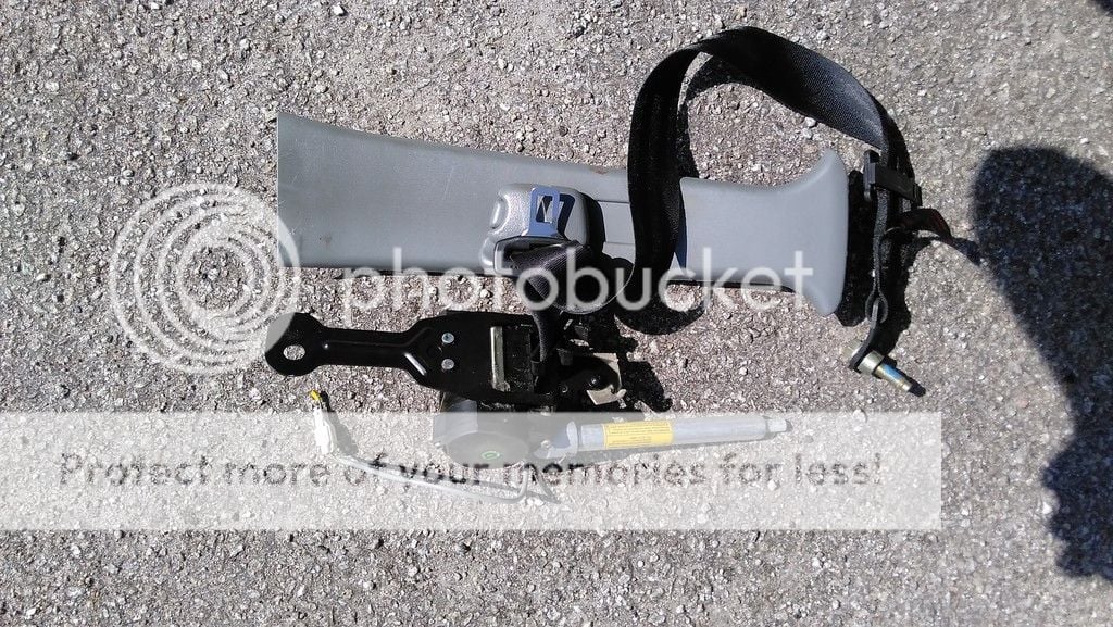

thanks for your replay
i have seen the connections of the belt reel by the seat, and behind the pillar cover.
turn off the connection from driver and passenger seat clean but the lights continues to flashing.
there is some photos
Nice collection of fluff there Ricardo - LOL
It is almost certainly the pre-tensioner that is faulty, you'll need to change that Ricardo to see if that is what is causing the problem.
This is what you're after, there are two different ones, but it is only the length of the barrel that is different - so check yours first before you get one buddy.
