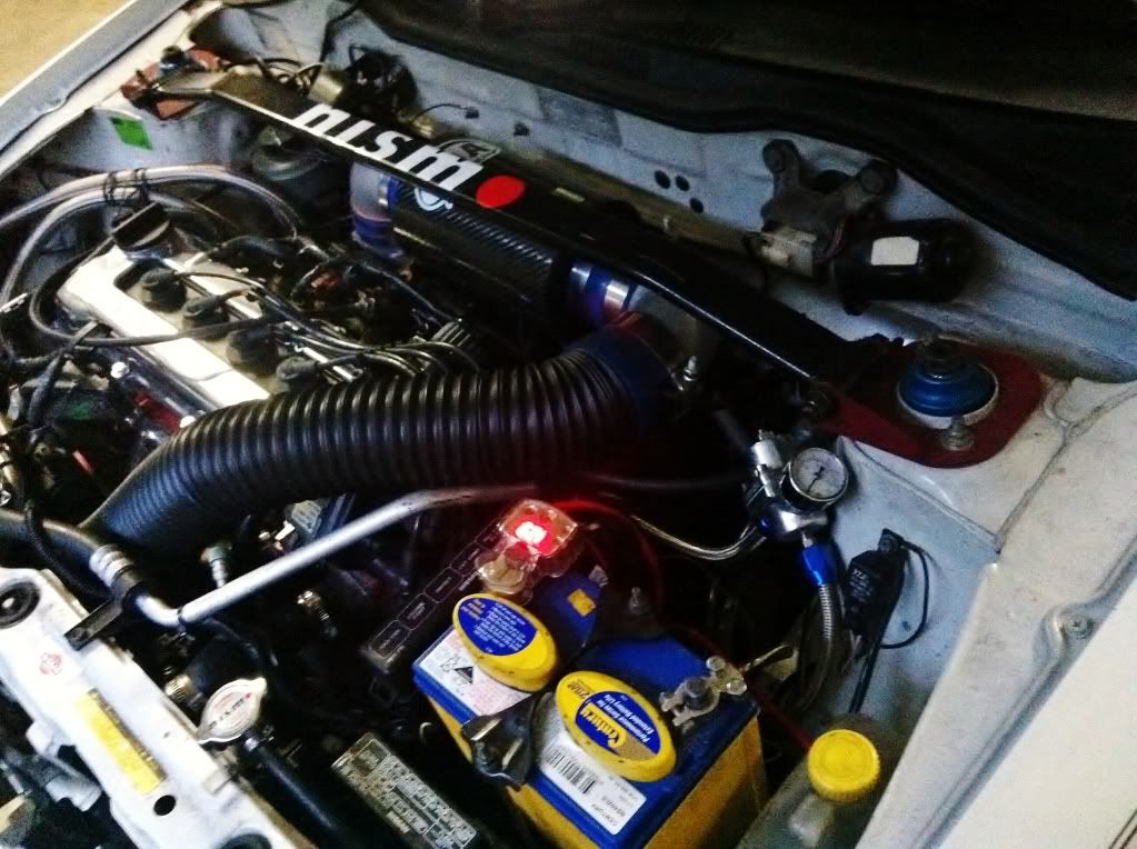

CMF_mycra
» CMF Member
Member since:
Posts:
usless bling but sure looks nice hey...
