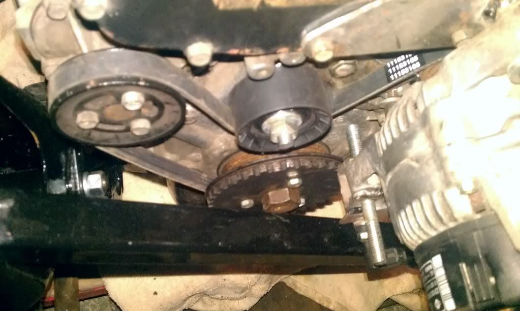

looking at fitting a 36-1 Trigger wheel onto the bottom pulley how do you mount it? and has anyone done it before?
how have you mounted your sensors? and are there any worth while upgrades whilst the engine is out the car waiting to find a decent shell?

Ed from fusion motorsport does the trigger wheel and sensor, not sure how easy it can be setup with the stock ecu though. I had it fitted onto the side of the crank pulley simply by drilling and tapping it. The bracket i had made up was pretty compact too but when fitted managed to rub the chassis and i gave up on the standalone management route as id wasted too much money
Did mine like this. I don't use the outer pully so machined it off and bolted on the trigger wheel
how did you go about lining it all up and drilling the holes into the pulley? will look at your build thread over on 16v as i think i might have missed something, also looking at your frame from this side i notice you have managed to get away with just putting a bar from tower to front!
Calculated the pitch drilled the holes, linned it up to the pully to with in 0.05mm clamped it and then spotted the holes.
The frame goes from towers to front and then under the engine/box back to the rear of the subframe.
