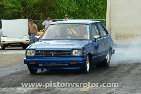

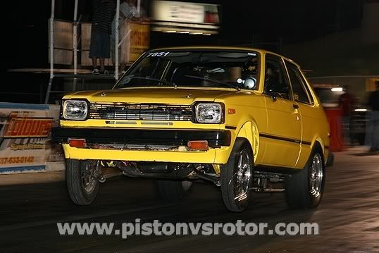

Yeah it will be a fun car and spectacular when finished, I'm planning everything now, will be the same concept as the KP61 starlets in Puerto Rico :

I know the Chassis isn't the best suited for dragracing but its very similar to the KP61 starlets with the exact same wheelbase of 90", and those starlets are running as fast as 7.2s now.
