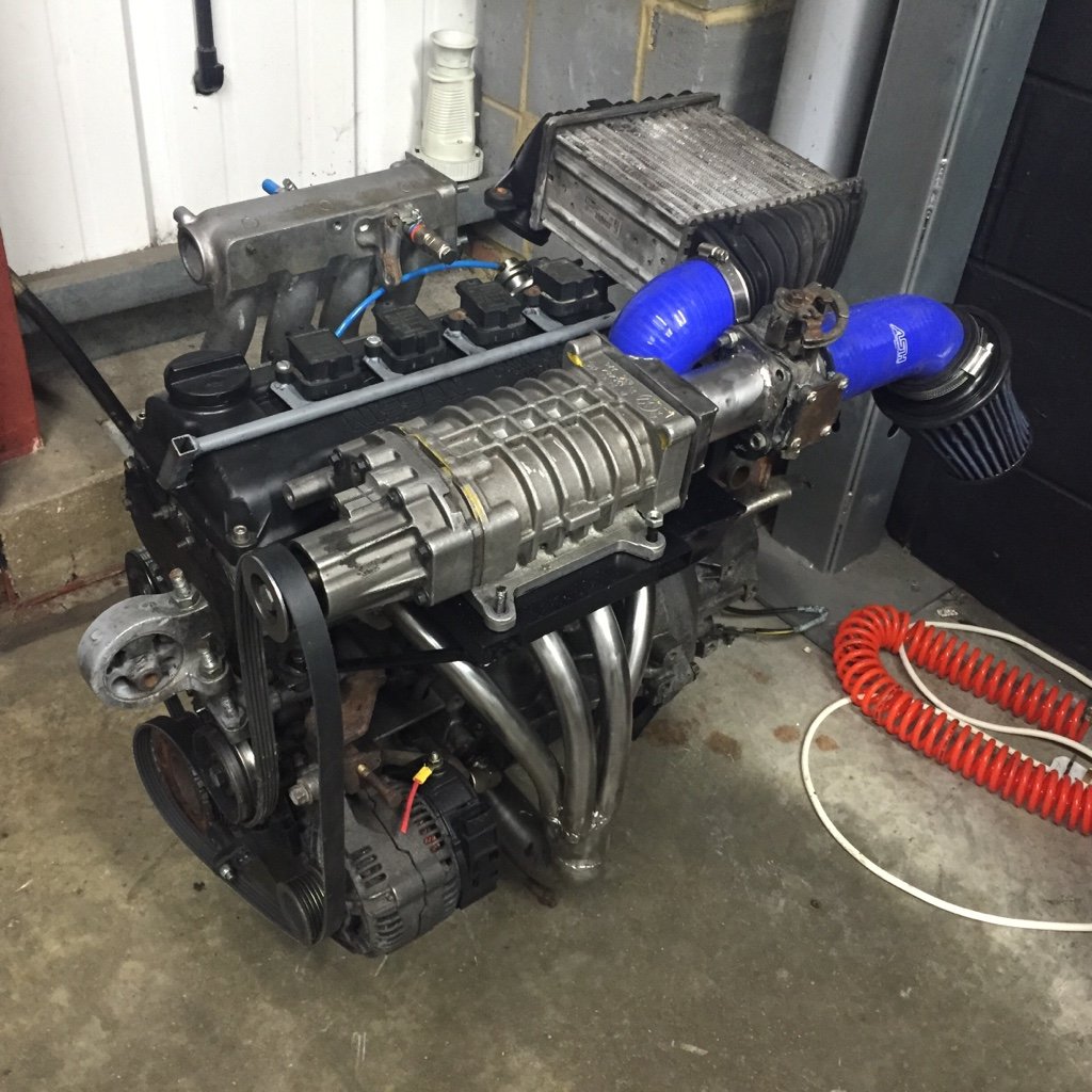

Here's mine

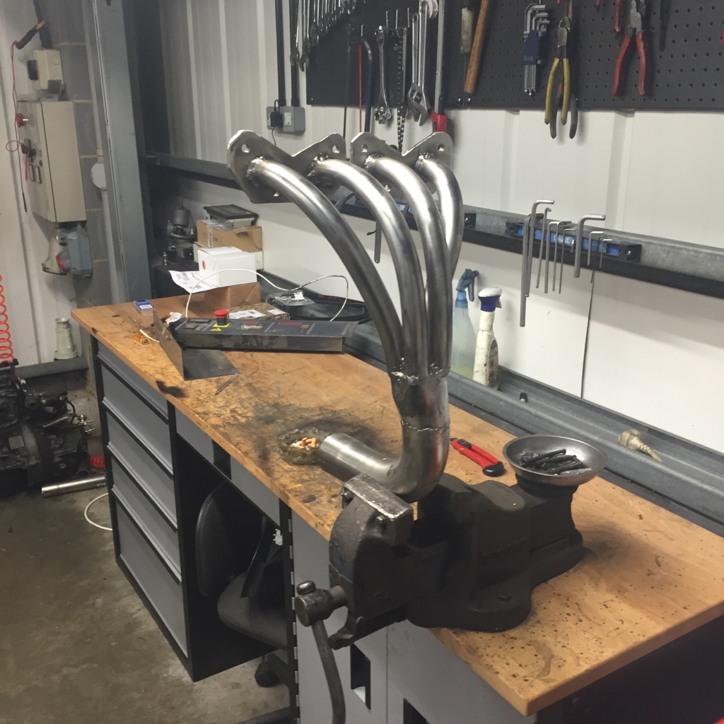

Used exhaust gaskets as templates for flanges made from 10mm stainless
Some Bent tubes and stick all together,
Couple hours work
Correct me if I'm wrong the Rover Tomcat comes with a turbo T16 k series lump? if it really is close it might be a little tweak and bolt on...
Leave it with me :)
Definitely not jealous of that. Looks like a tidy install. I want to add a electronic clutched supercharged to mini. Then she'll have a sport button!
